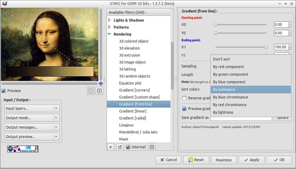

In fact, I've also pushed a new version of the filter, with even more options for sorting the final color gradient :

@Molly - In this case, you must use the G'MIC preview to see which section of the image you are actually sampling for a gradient. If you are using a large image and want to sample a gradient from a small section, you will have to crop the image down (and possibly resize the cropped section up to fill the preview window) before you'll be able to accurately sample that section.

GnuTux, another possibility is to first select a sub-region (no need to explicitely crop), then run the G'MIC filter on it.
