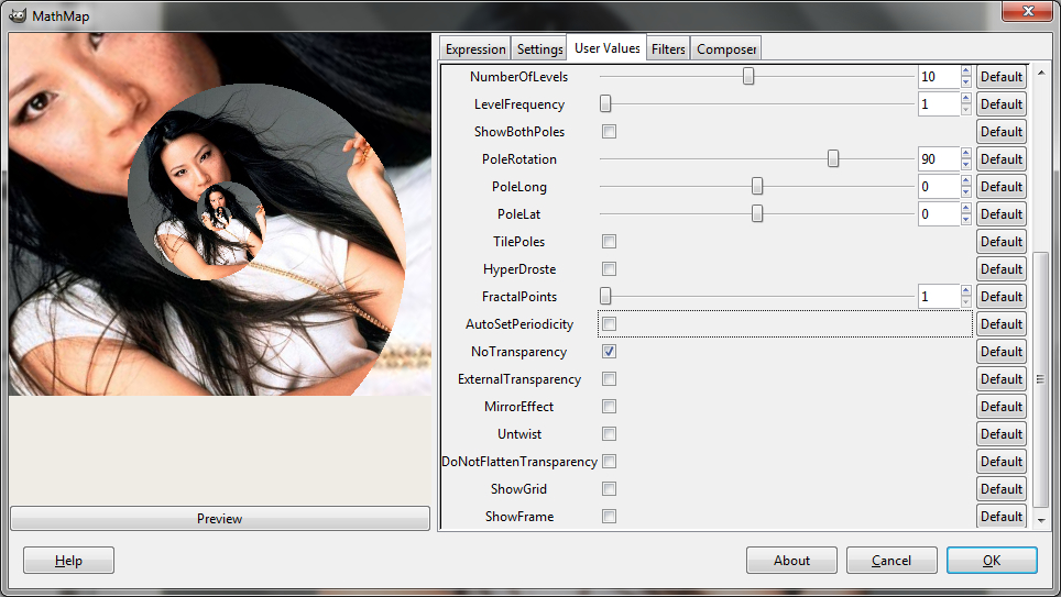

I reported this issue on the G'MIC Flickr page, but the issue still exists. It's in Deformations>Continuous Droste. The Continuous Droste is unable to create the standard circular Droste. In Mathmap it works normally, but in G'MIC it comes up rectangular and is unable to create the standard circular Droste. The circular Droste is actually used more often than the rectangular, so it is something to be looked into.

This shows the actual outputs for example.

OK, I just got an email from David. I have a bit of time now though I'll be away for a few days soon. So you are saying that every option is the same between MATHMAP and G'MIC and External Transparency is ON. Then the difference is when No Transparency is also ON. Is that right?
 Post subject: Re: Release of G'MIC 1.7.2
PostPosted: Sun Jun 19, 2016 8:46 pm  (#59)
Joined: Jul 04, 2010
Posts: 2253
All the settings are the same, External Transparency is Off and No Transparency is On. (the spiral image)
If I set them both to External Transparency on and No Transparency is Off, the result is identical. (the rectangular image)
If I set both External Transparency and No Transparency to On, the result will also be different.
The No Transparency flag appears to be the problem.
My Sigs = My Photos
PostPosted: Fri Jul 01, 2016 1:15 pm  (#60)
Joined: Dec 19, 2015
Posts: 46
Finally had time to squash the bug. Wait a couple of hours after this post and refresh your filters. Any other weird stuff, let me know.
