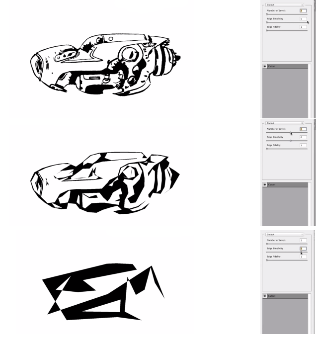

Photoshop has this so called 'Cutout' filter.
It simplifies lines and shapes and its very useful for making stencils.
In this video you can see how it simplifies these ships into a bunch of abstract angular shapes:
starts at 2m22s
Here you can see the Cutout filter in effect for a 'Obama-Hope Poster' style effect
starts at 7m35s

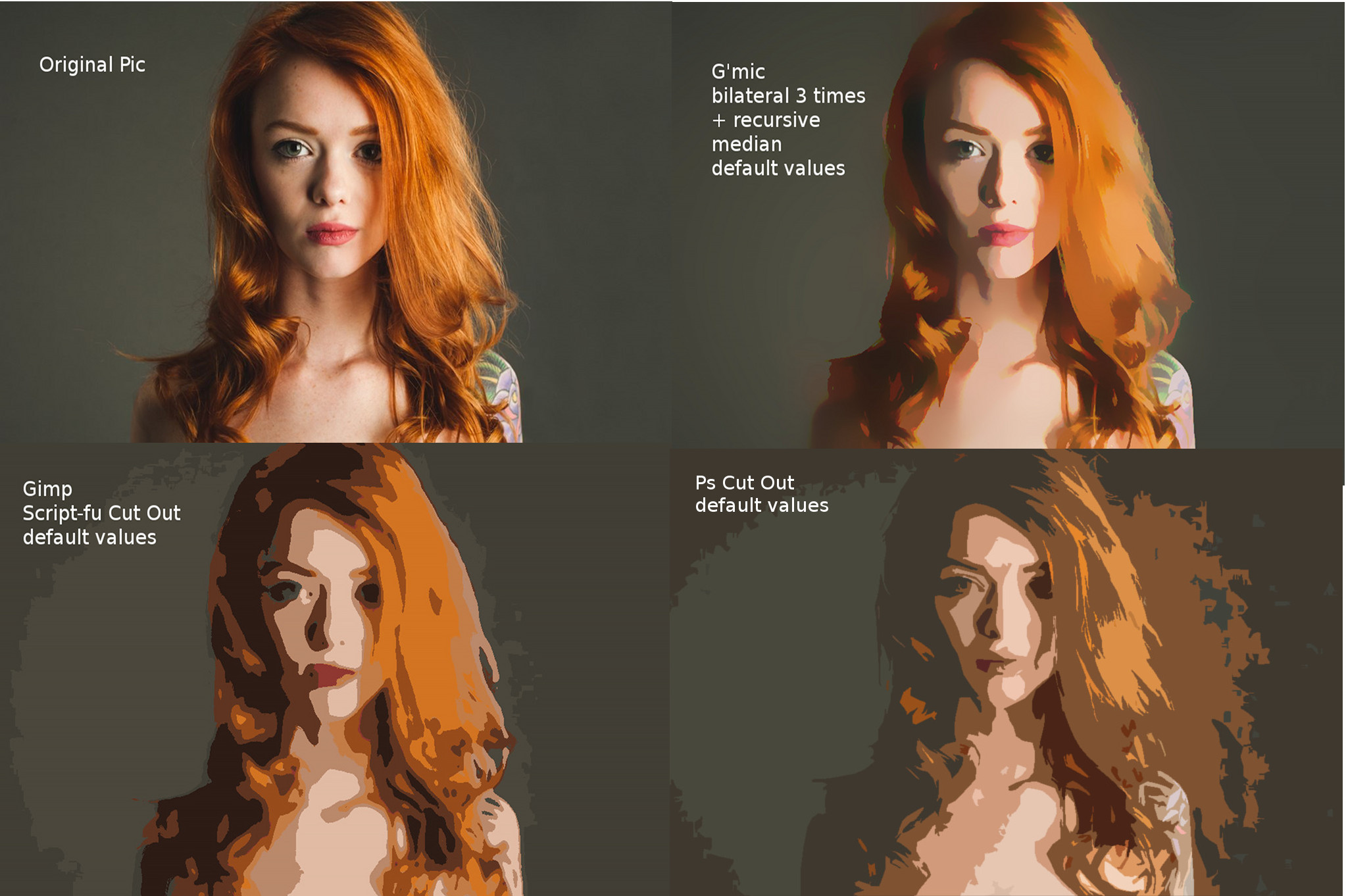

I tried to replicate the effect with G'MIC smooth [bilateral] and recursive median filtering, but it doesnt work that well.
Could a new filter be written for G'MIC, maybe ?

Gimp has a script Cut Out allocated in Script-Fu → Artist → Cut Out with two parameter to work instead the three oneś of Ps.
My attemps (default values)

from the examples jamac4k provided, to my taste the outcome from GIMP filter looks much better than the one coming out from PS! (aesthetically speaking...)
a matter of opinion...

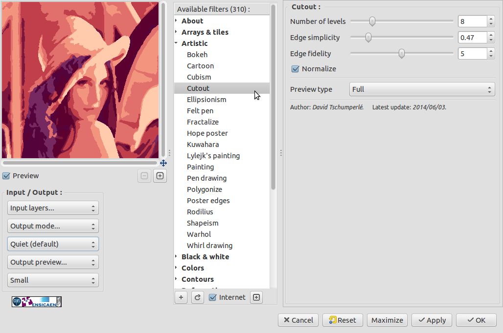

Something like this ?
Maybe, try to refresh your filters!

pretty cool ! :clap
can you add a smoothing option, please ?
EDIT: also i get funny added background in the preview, where there should be transparency
 Post subject: Re: is there an equivalent to the Photoshop 'Cutout' filter ?
PostPosted: Tue Jun 03, 2014 2:56 pm  (#9)
Joined: Jan 03, 2011
Posts: 1656
The Edge fidelity parameter already tells about the amount of edge smoothing.
Transparency problem should be fixed now.

David, trying your new Cutout filter and I'm getting the preview error and this
Is this a back compatibility issue [because my current gmic version is 1.5.8.1] or a bug?
Edit: Updated to the latest version, works fine :)

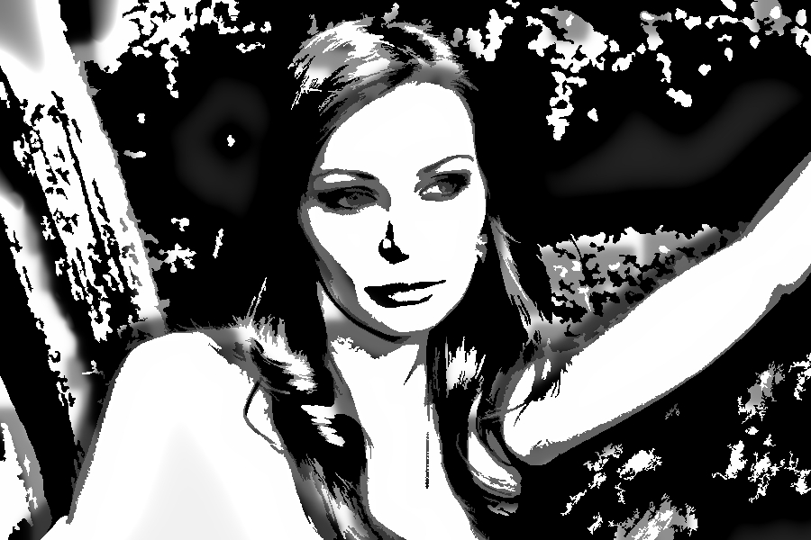

Sallyanne this is the image I used↓
these are my Gmic settings↓
This is the output↓
after applying Gmic's 'Black & White' with 'Local Contrast' set at 40 filter↓

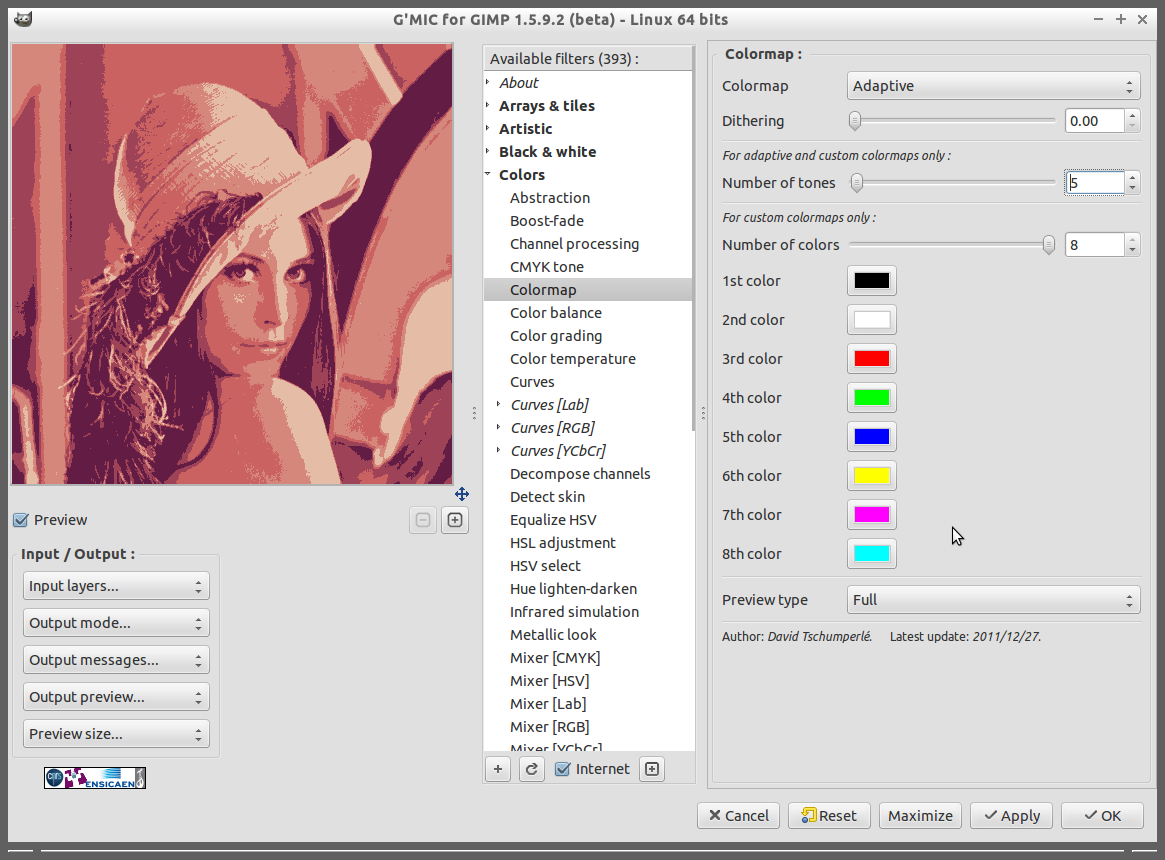

And yes, there is a quantize filter in G'MIC, in Colors / Colormap, as shown below :
