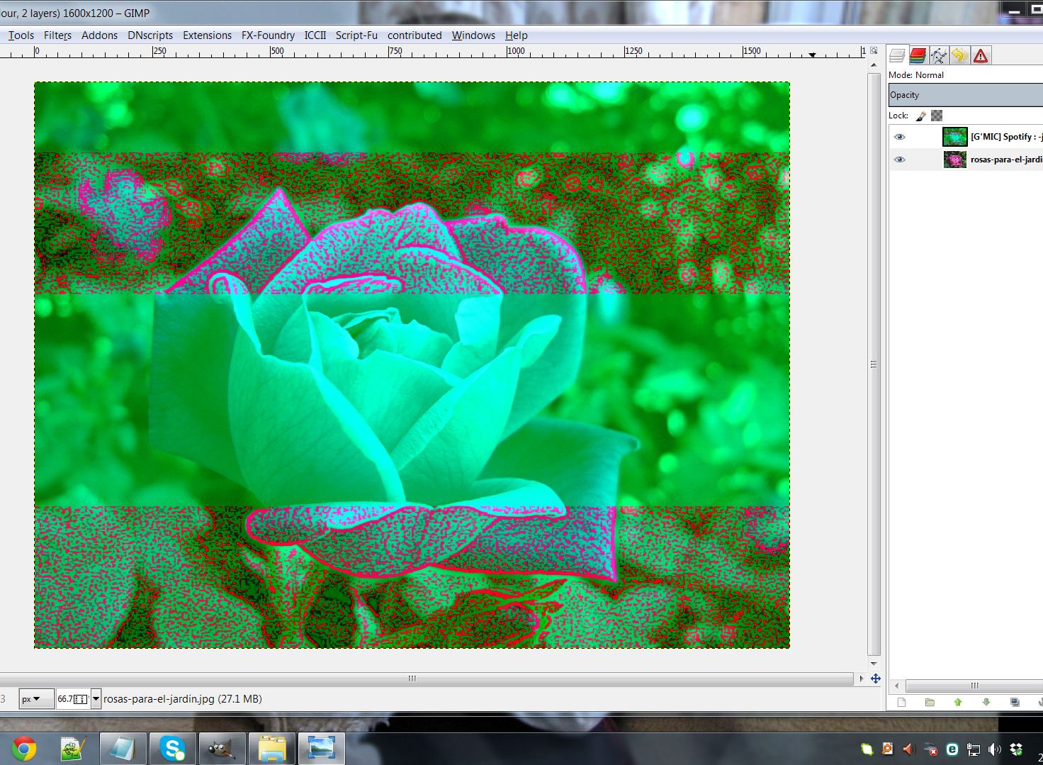

Hello, I'm trying to apply this filter and after running it I get a odd outcome. There are wide stripes crossing the picture. I don't know if it's only a flaw on my side or if someone has the same problem. It only happens in this filter not the other ones.
I add screens so that you can see the problem. Thank you so much in advance. :tyspin

I can't replicate your issue. The fact that your result doesn't even remotely mirror the preview is very strange. Although at first I thought it could be a system graphics issue, I don't think that's it. Was the original edited beforehand (because it looks like a mask)? Have you tried a different image with the same settings?

This looks like another multi-processing problem ..I'm running on a 2-core laptop and I only get half the image processed.
(I presume Issabella is running on a 4-core machine.)
Furthermore, it's NOT a regression in the latest GMIC (1.6.1.0 beta) ..the same thing happens with GMIC 1.6.0.3.
"Channel" modes "All" , "Blue/red chrominances", "ab-components" and "Hue" seem okay, most of the rest fail.
I think Ronounours should see this.

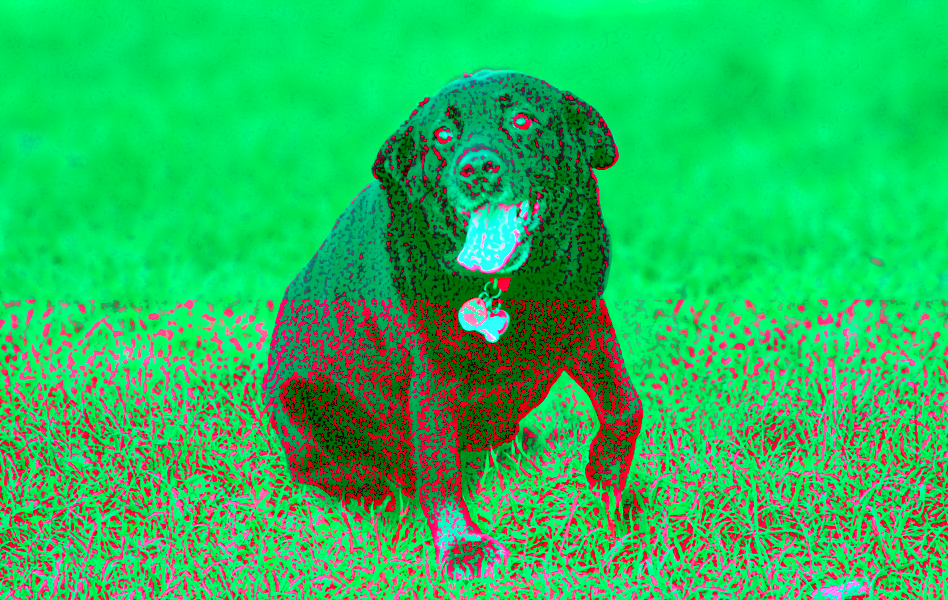

I'm seeing it. Just happen to have a test dog left over from another post.
Same settings as Issabella's.
Like jonait2's theory.... Into the hunt.

Tried it again on my laptop with multiprocessing disabled (at start-up) and Spotify works okay in all Channel modes.
So it does look very much like a multi-processing problem.

Thank you all for your interest on this problem. The odd thing is that it happens only applying Spotify. Grosood, your outcome is just as mine.
Odin, the pic hasn't been edited before, it's a original one. And Yes I tested spotify on other different ones and I get the same outcome as the one I dropped here.

The problem is that this filter apparently doesn't use any explicit parallel processing. It does in fact run in parallel, but using OpenMP built-in functions, not explicit threading. This might sound as a detail, but to me, this means that the bug may come from the OpenMP pieces of code of G'MIC instead of the 'spotify' command itself. In brief, this is probably not easy to fix with a simple filter update :)
So far, on Linux, I haven't been able to reproduce the bug. I've used the same parameters as you, the same kind of image dimensions, but without success.
So, maybe the bug is happening also only on Windows ?
Any additional information is welcome, to better understand the problem.

I've been able to reproduce the bug on Windows too. Looks really like a problem with the way OpenMP parallelizes the loops in the G'MIC code :(
What I've noticed is that if you get the bug, then undo the action (CTRL+Z), then run the filter again (CTRL+F), sometimes it will work.
On my virtualized machine, I'd say it works 2/3 of the time, and I get the bug 1/3 of the time.
That is bad news because :
- It probably also affects other filters.
- I don't know how to solve this, apart from removing OpenMP support when compiling G'MIC on Windows (which would slow down almost all available filters).
Maybe there are some compiling options I need to give specifically to get rid of this OpenMP problem, I'll check.
But as far as I understand the bug, it looks like another Windows-specific problem to deal with :)

Yep. Ditto here. The Defective Dog was rendered on a Linux box, running Gentoo. Currently the G'MIC 1.6.1.0 beta.
Linux harriet 3.17.8-gentoo-r1 #1 SMP Sat Feb 14 05:04:14 EST 2015 x86_64 Intel(R) Pentium(R) 4 CPU 2.80GHz GenuineIntel
