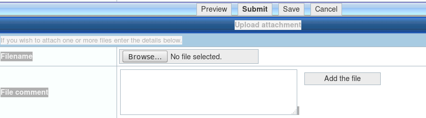

You can use the attachment below to upload your image
OR, after you have made 5 posts you can use this upload file button Image
