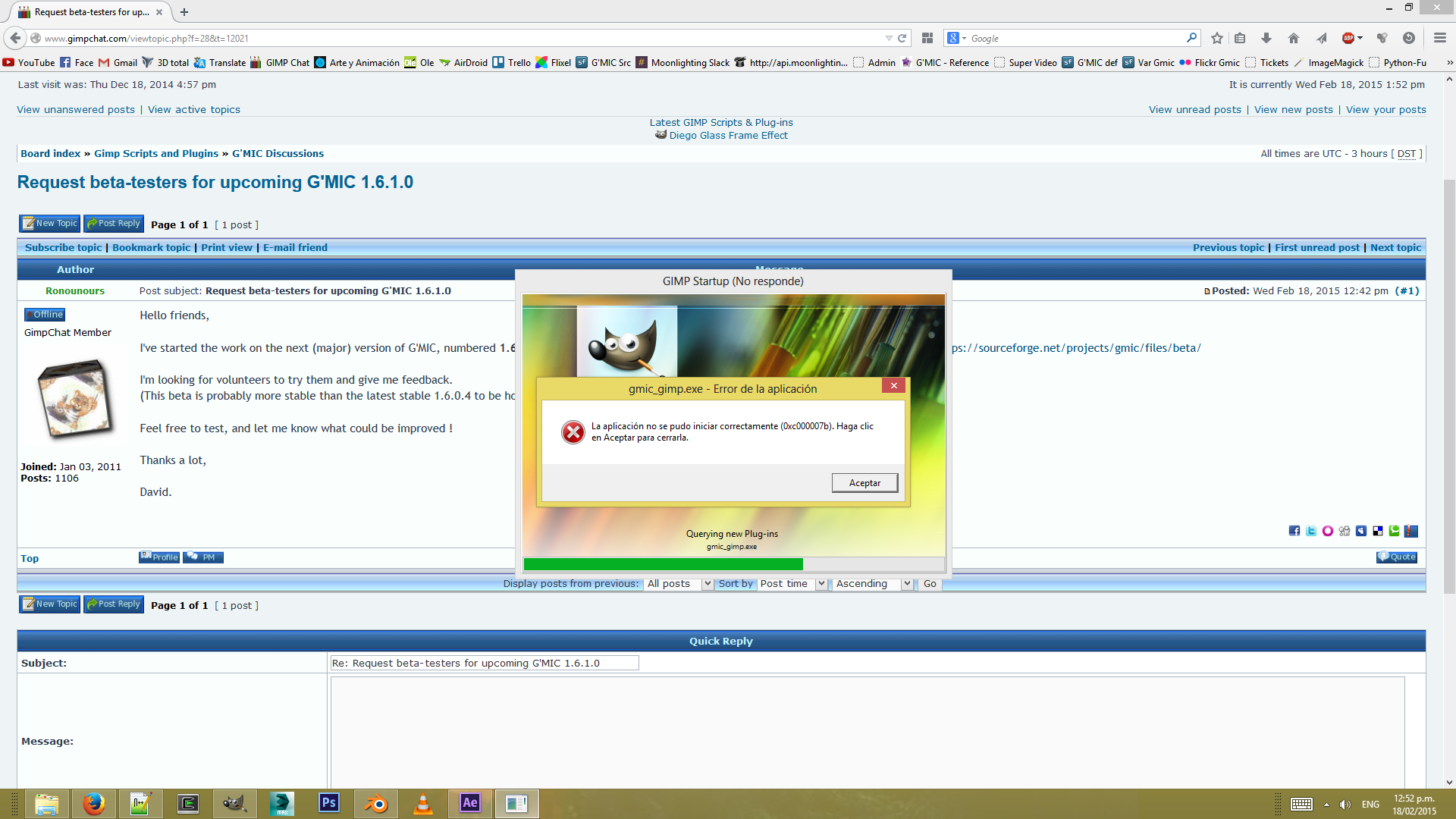

Hi David, I tried with gmic_gimp_1.6.1.0_beta_win32.exe and got this error:
With gmic_gimp_1.6.1.0_beta_win32.zip all worked well
