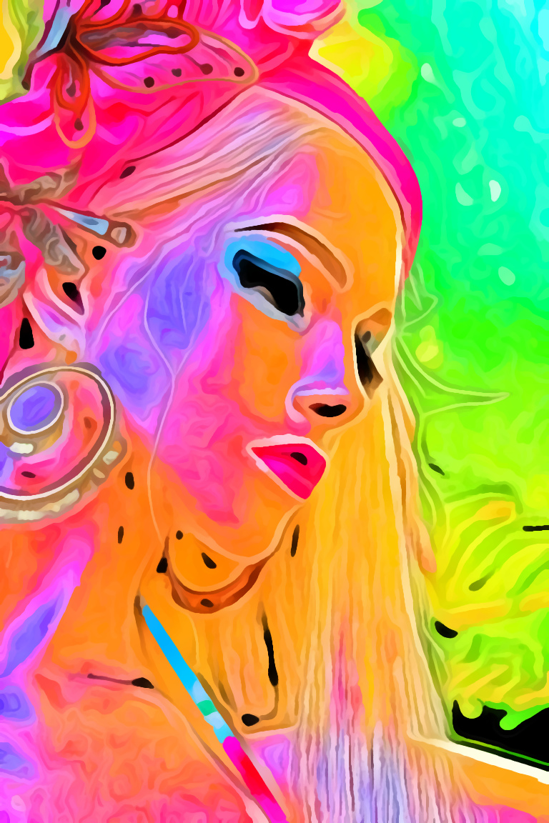

Gives a very heavy red output. This preset had this problem before but was fixed. Not sure why this problem came back again. :)
 Post subject: Re: G'MIC Paint preset is not working right again.
PostPosted: Wed Apr 01, 2015 2:07 pm  (#2)
Posts: 12850
Example of what I'm referring too.
ref: http://www.fontplay.com/freephotos/sixt ... 06-018.jpg
Could be a cool result, but I use the behavior of the original paint preset for other things. :)

Thanks Lyle !
It should have been fixed now :)

Indeed it is David (after a refresh that is). Still, I can see the previous result useful for hypersaturated painting renders. Thanks a heap. :)
