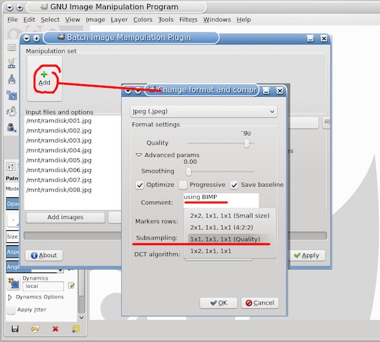

file-jpeg-save 0 %i drawable %i %i 90 0 1 1 comment 4:4:4 1 0
Not quite sure what that is intended to do, but for a GUI you could try the BIMP plugin http://www.alessandrofrancesconi.it/projects/bimp/
Here changing the jpeg compression, subsampling and adding a comment
