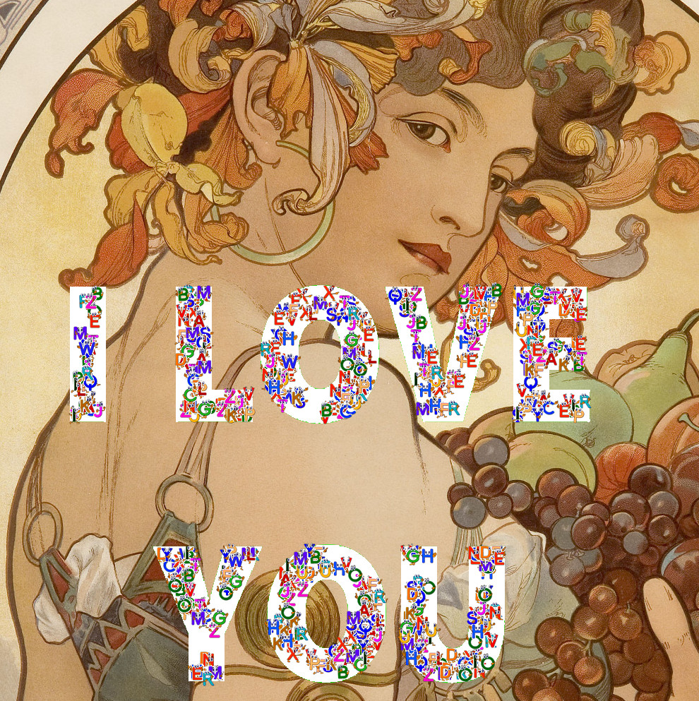

maybe I'm again missing something, but let me tell you, David, some doubts on -for me- unexpected results from your Pack Sprites (very very nice!) filter.
Let's take a base image (BG + mask), such as this one:
(text is shown as white but it's really transparent)
Let's take a lot (26) of sprites to load as layers on top, like these:
TEST_LETTERS_2.7z [2.1 MiB]
Downloaded 224 times
Now I run Pack Sprite with the following parameters:
pack_sprites 10,10,0,-7,7,1
as you see, I set angle=0 for this first test (-7 as spacing to let letters overlay each other)
I get the following result (nice)
Fruit-Alphonse-Mucha_BG_pack_sprites 10,10,0,-7,7,1.jpg [ 547.38 KiB | Viewed 5038 times ]
now, let me continue with the next post...

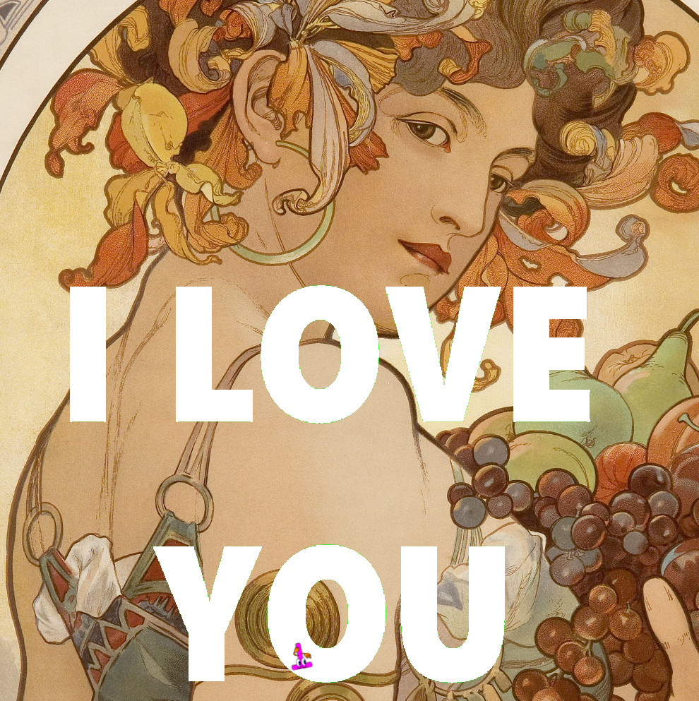

 Post subject: Re: experimenting Pack Sprites
PostPosted: Sat Oct 10, 2015 3:48 am  (#2)
with this second test, I want to see how spaces can be filled using "any angle"
thus I run the filter with the following parameters
pack_sprites 10,10,3,-7,7,1
as you see, only the "angle" parameter has changed from 0 (do not change sprites orientation) to 3 (manipulate sprite orientation using any angle)
here the surprise, this is the outcome:
Fruit-Alphonse-Mucha_BG_pack_sprites 10,10,3,-7,7,1.jpg [ 413.59 KiB | Viewed 5037 times ]
is there a bug?
thanks

to complete the info for David:
also using option 1 or 2 (180° or 90° angles) the text area in the outcome is either totally empty or showing 2 or 3 sprites

not to multiply Topics I insert here a subtopic: PERFORMANCE still relatively to this G'MIC filter:
in case you David open the code to check whether there is or not a bug related to the "degrees", could you just get an eye whether it could be possible (maybe not) to improve performances?
on my current PC (not a bad one, Intel Icore5 with SSD as primary disk) I get the following results:
-input is the same image as per initial topic, but the set of sprites is composed only with 9 flowers
-test have been made with 3 different image sizes: 500, 1000 and 2000
to get the outcomes the elapsed times were:
- 45 seconds on the 500 image
- 210 seconds on the 1000 image
- 995 seconds on the 2000 image
results were all very nice (I continue using the 0 degree option, to avoid problems)

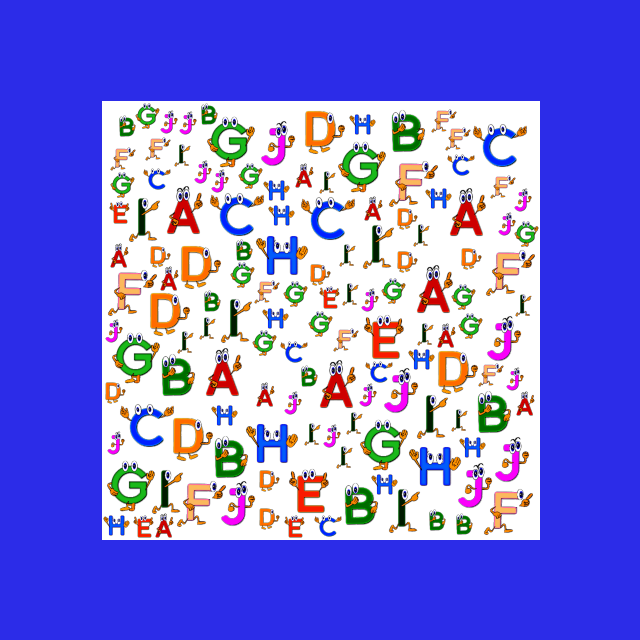

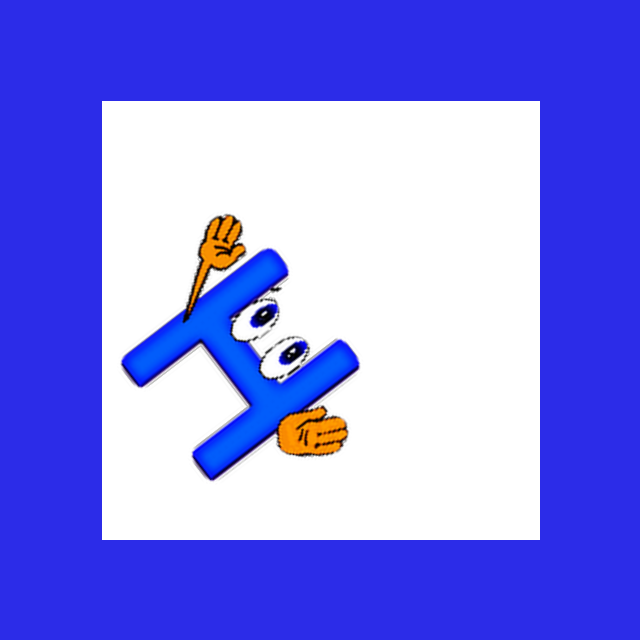

 Post subject: Re: experimenting Pack Sprites. Is there a BUG?
PostPosted: Sat Oct 24, 2015 9:23 pm  (#13)
David, maybe I discovered the problem in the algorythm:
- the parameter "minimal scale %" is NOT taken into account when selecting "all degrees", while it is appropriately taken into account when selecting "0 degrees".
New test:
- as a base image just a squared hole (440*440) surrounded by a frame (image 640*640)
- as sprites a series of letters (only a few) with a quite big size (300*261)
- parameters: 10 numbers of scales, 10 minimal scale %, mask as bottom layer
Test1: option "0 degrees" : excellent outcome, sizes have been appropriately reduced to fit in
Test2: option "any degrees" : outcome with just one letter, NOT rescaled
- outcome of Test1
- outcome of Test2
hope this info can be useful
