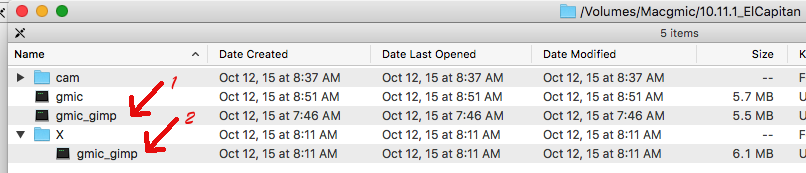

Ahh, success, I finally got it installed.
Now I have 1.6.6.2 [pre-release #101215] - Mac OS 64 bits
BTW why does the DMG often have 2 versions in it ?
I used the second one which seemed to work.
So, thanks again there.

Gangle: The plugin version in folder X is build with display on. This version needs an installation of XQuartz (X11) for the interactive Gimp functions on your machine.
Rod: That is true. I am using the Gimp from GimponOSX, I have no build environment for Parthas build. If Partha would prepare in-time the latest (pre-)releases of gmic_gimp plugin, I would immediately stop this building task!
By the way, the plugin is only a friendly addition for interested Gimper! I am mostly using the cli version in my work!
