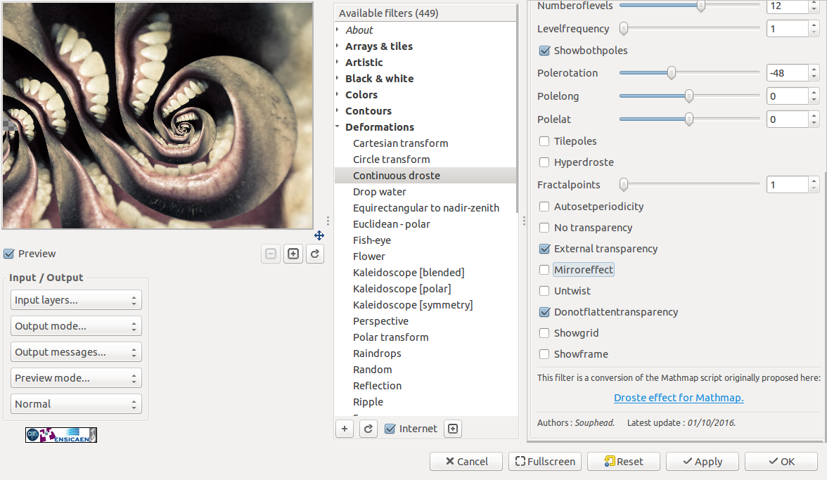

And here it is! Thanks to Souphead, this popular droste filter is now available for everyone.
Thanks again Martin ! We will enjoy this cool effect !

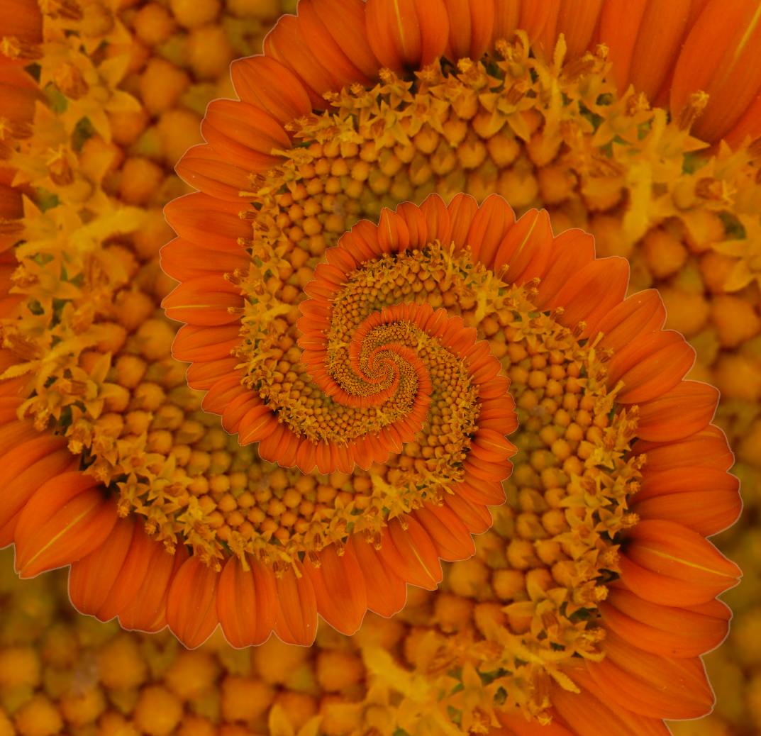

OK; had to toy with the settings a bit Diego, but here is my original (for the example, above, I blew the image up, but did not do so for the log file) and log file. :)
[gmic_gimp]./preview/ -v -99 -souphead_droste10_preview 15.1,50.5,2.5,6,1,0,0,0,0,0,5,10,2,0,88,0,0,0,0,1,0,0,1,1,0,0,0,0
[gmic_gimp]./apply/ -v -99 -souphead_droste10 15.1,50.5,2.5,6,1,0,0,0,0,0,5,10,2,0,88,0,0,0,0,1,0,0,1,1,0,0,0,0

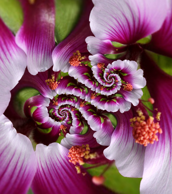

And, why not click the show both poles option (only lowrez this time). :)

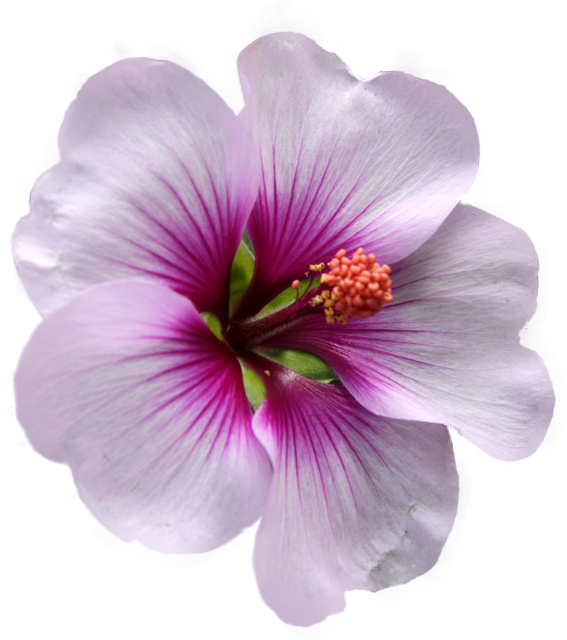

And, using the same settings (but unclicked the show two poles) is my extracted Tithonia from a few years back. Just amazed at how fast G'MIC processes these. :)

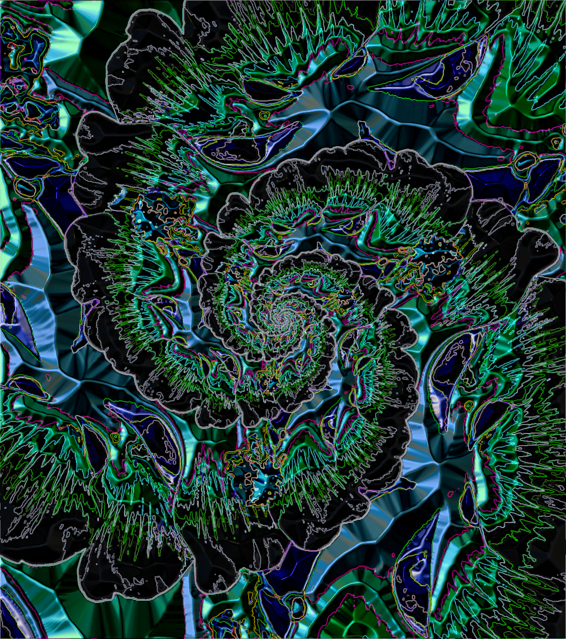

As an hommage I took that outcome and played with some crystallizing ...
