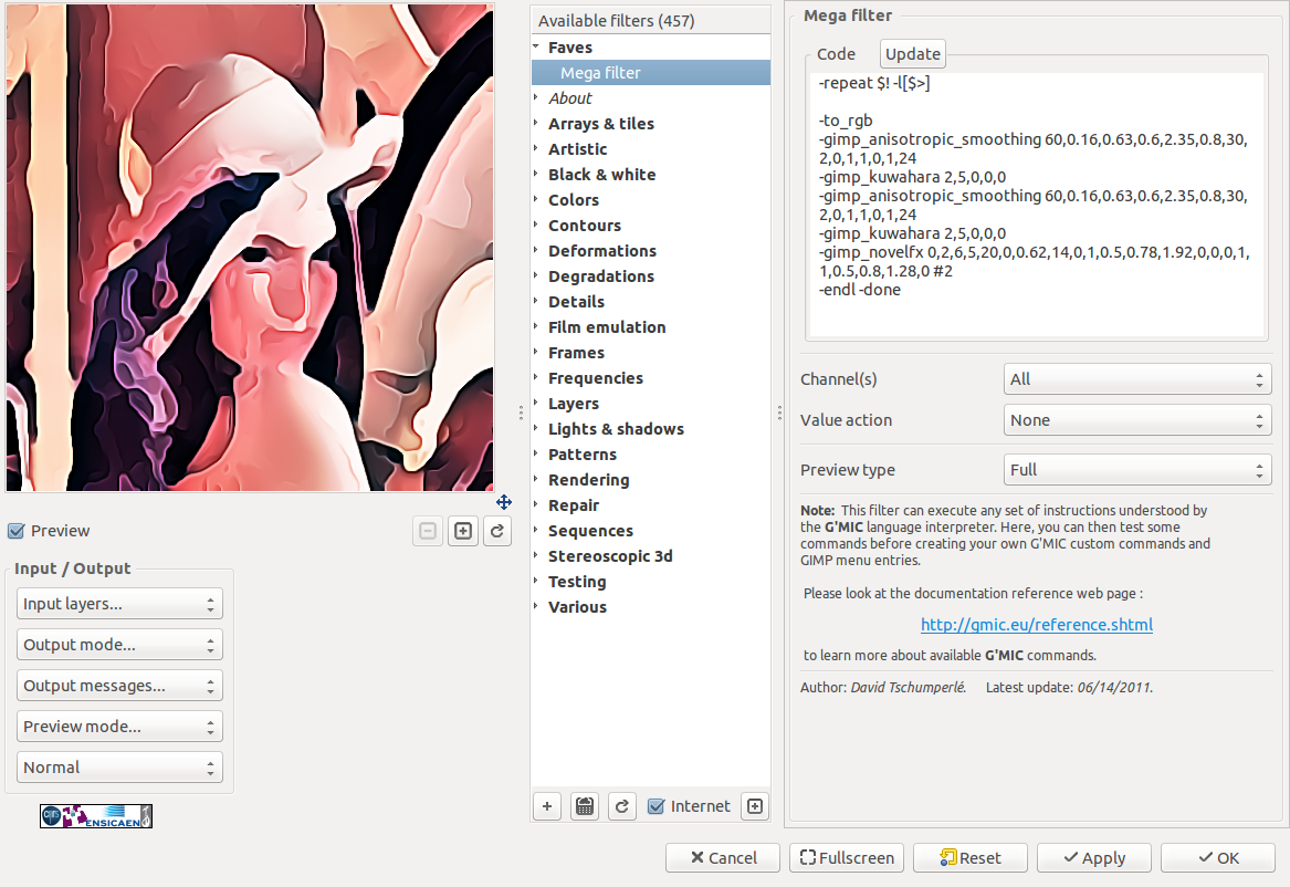

Don't suppose You could tell me how to make it a permanent part of my G'MIC. (I understand Your instructions do that, but if I wanted to email to a friend how would I do it?) Could I just put it a plain text file somewhere for G"MIC to find? (Like a Gimp script/plugin)?

To add it as a 'permanent' filter, in your Faves, just copy/paste the text, then add the filter as a favorite.
You can rename the filter afterwards, by double-clicking on its name (in the Faves section).
Just as in the screenshot below.
