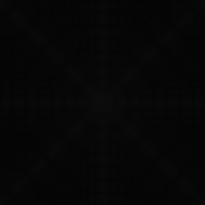

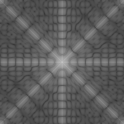

Ok, thanks. If I won't find another way to export NORMAL pictures I use that library. BTW, how to make GMIC to export pictures like in preview screen? When specifying .png as an export extension, it exports almost black picture (because it saves colors rounded to integer, not scaling its values to 255). Just compare pictures below (you'll need to move the white point on "black" image according to histogram).

See https://discuss.pixls.us/t/exporting-ff ... gin/1076/2 for additional info :)
