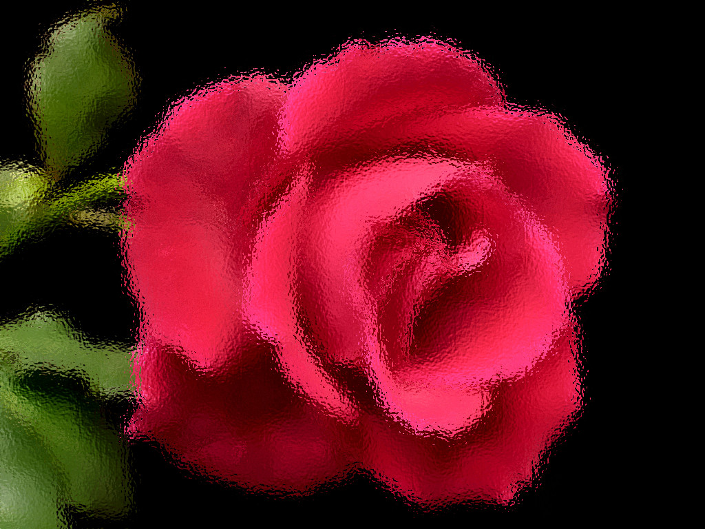

done another test in colours (I don't post the original, it's my commonly shown red rose)

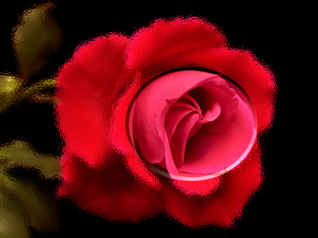

here it is

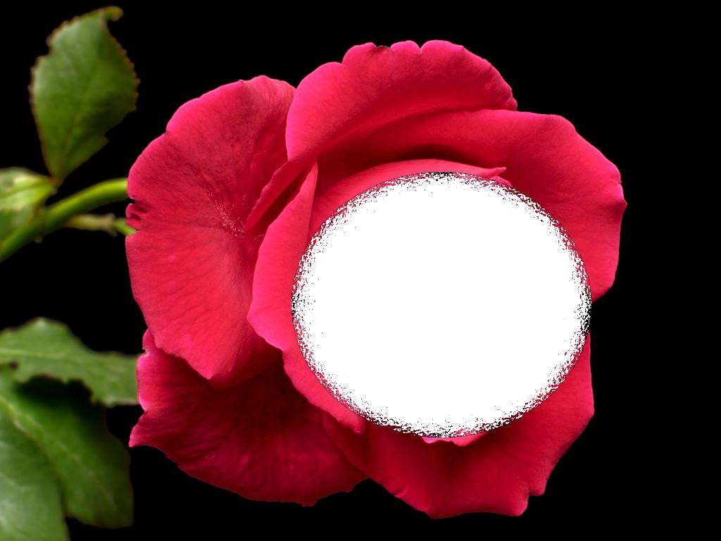

NEITHER IT DOES OVER A TOTALLY WHITE AREA

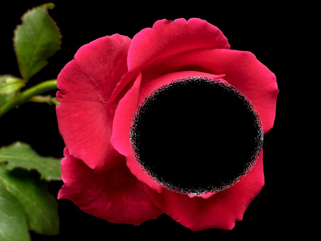

...NOR ON A TOTALLY BLACK AREA
