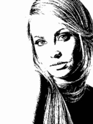

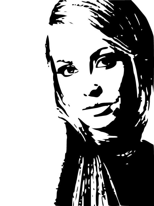

I took this:
Ran the G'MIC Stamp filter:
Then took it to potrace to finalize:

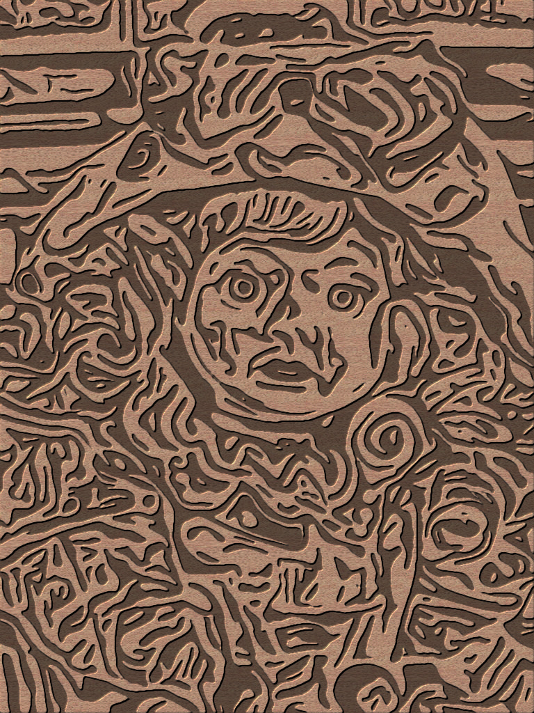

 Post subject: Re: Stamp Filter for G'MIC
PostPosted: Mon Mar 28, 2011 11:47 pm  (#18)
Hmmmm... that looks pretty good, considering. Are you happy with it?
PostPosted: Mon Mar 28, 2011 11:53 pm  (#19)
This one is small but I think it turned out rather nice.
PostPosted: Tue Mar 29, 2011 12:00 am  (#20)
Posts: 12850
Maybe a little abstract, but when applied to wood engravings via bumpmap on texture, if makes more sense. I use this technique a lot for such renders. :)
