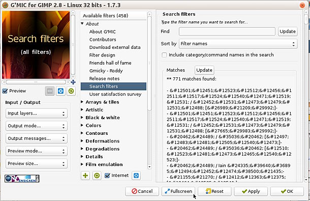

On my installation, search is broken for 1.7.4/1.7.5pre (which seem to be identical, at least have the same file size).
Works in gmic 1.7.3 eg............
