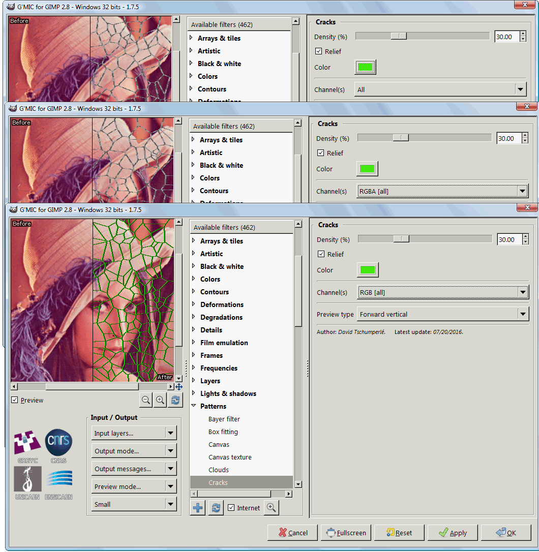

PostPosted: Sat Sep 03, 2016 12:33 pm  (#9)
On the margins of the new filter Cracks:
- open the image and add alpha channel.
- run filters Cracks:
- select channel all - color selection does not work
- select channel RGBA (all) - color selection does not work
- select channel RGB (all) - color selection works well.
Is not that a mistake?

 Post subject: Re: syntax for filter "Cracks"
PostPosted: Sat Sep 03, 2016 2:17 pm  (#10)
Joined: Jan 03, 2011
Posts: 1656
Many thanks for noticing this MareroQ, this should have been fixed as well !
:hi5
PostPosted: Sat Sep 03, 2016 2:52 pm  (#11)
Hi David.
Thanks for the quick repair - now it works.
