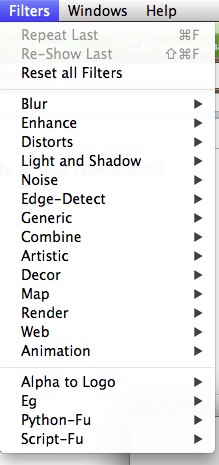

That is quite interesting, since the original Mavericks Gimp from GimponOSX has the gmic plugin inbuilt. Only the version is not recent. You should once more look into the filter menu. Gmic is at the bottom greyed out. This will change if a feasible image is open!
 Post subject: Re: G'MIC Not Showing?
PostPosted: Wed Feb 26, 2014 6:53 pm  (#8)
Joined: Feb 26, 2014
Posts: 7
It could be some antivirus/security software... I'll check that.
I'll also reinstall GIMP to make sure.
This is my filters bar.

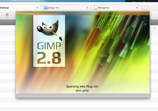

I reinstalled GIMP to see if it was working, and quit. Then I put gmic_gimp into the plug-ins folder again. When I opened GIMP I saw this!
This just confuses me!
And G'MIC still doesn't show up in the filters!

Your filter bar is what shows up when you have downloaded the 32bits version (gives Python-view etc) G'mics apparently needs 64bits, and will then show as G'mic in filter bar.
