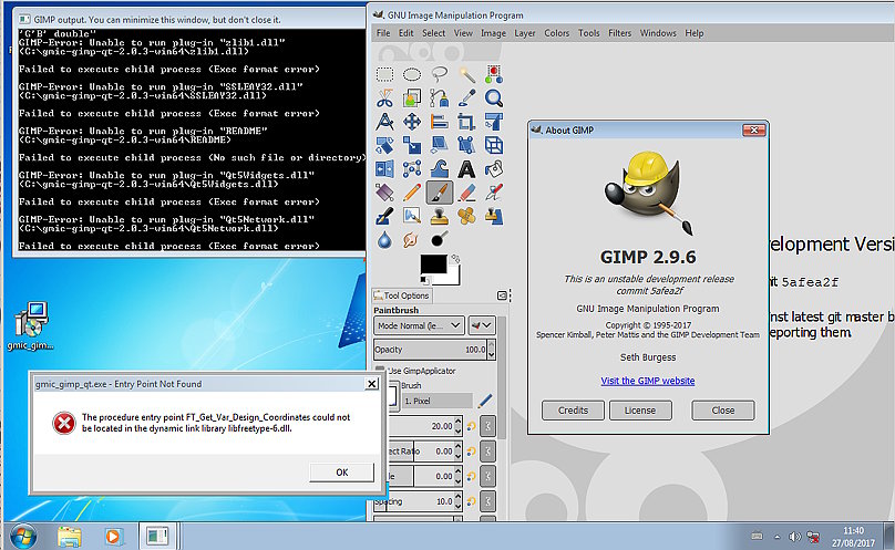

Looks like it is a problem with Gimp 2.9.6
Does not matter if the gmic installer or zip is used and where the folder is situated (tried various combinations) you get lots of errors.
This a Win 7 64 bit VM
