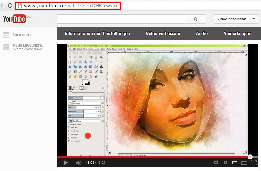

Here is a screenshot.
The tutorial show you how you can create a nice looking watercolor effect using G`MIC.
Filters: Segmentation, Egde.
The handmade parts comes from custom brushes.

@2-ton, i use these filters:
1 Enhancement > Smoothing (bilateral)
2. Contours > Segmentation
3. Contours > Edges (layer mode: divide)
4. Then use a layer mask and paint with these brushes:
http://chrisdesign.deviantart.com/art/w ... -326284761
5. Add a fin art paper texture or simply use G`MIC Patterns > Paper texture
