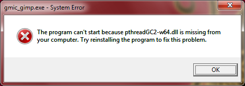

I believe there are some missing dlls that need to be included in order to get gimp-gmic to work inside GIMP. Below's an error that I get on startup; might be of use. GIMP G'MIC, unfortunately isn't recognized in GIMP 2.7.3 64-bit. :)

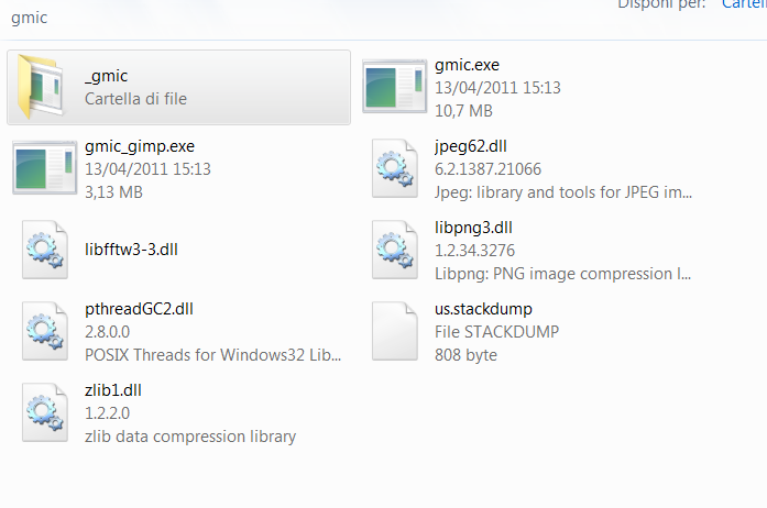

on the usual version there are 5 dll included
and in that folder"curl.exe"
i didn't try yet i just opening now the zip and i noticed what in

No didn't worked for me is missed ptrheadGC2
@Lylejk no will not work or at least will not solve for the error with ptrheadGC2 because want a different version
