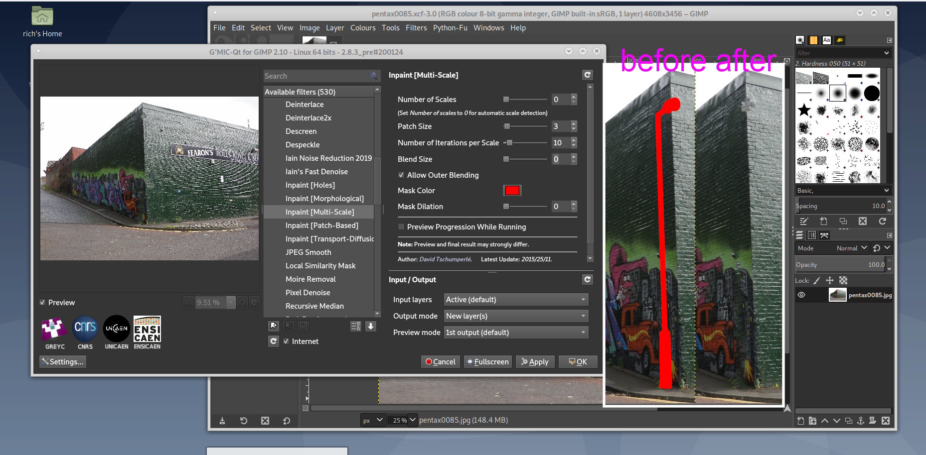

I normally use kubuntu 18.04 / Gimp 2.10.14 / compile my own gmic_gimp_qt
However, this in a Debian 10 VM / Gimp 2.10.8 / my gmic_gimp_qt 2.8.3 and a lamp post removal.
So it should work, not over quick, a couple of minutes for that 4600 x 3500 px image. Not wonderful either, If for real I would maybe divide into 3 sections with slightly different parameters for each bit.
