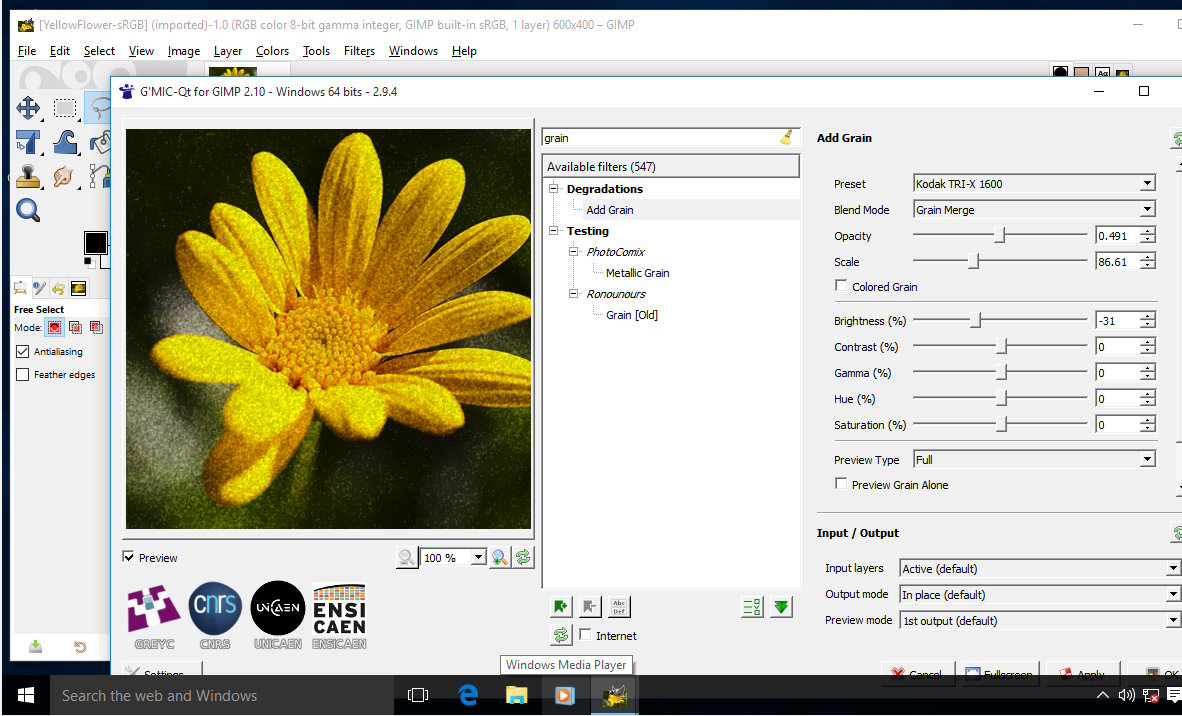

In an old tutorial from Davies Media, it indicates the GMic filter "Add grain" but I have this error message:

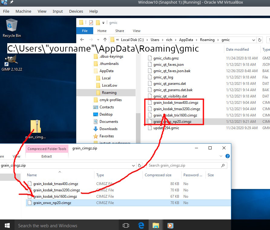

The answer is in the error message, There are lots of filters that are not there initially. There are hundreds of them. Gmic tries to download the relevent file as required. https://gmic.eu/data_film_presets/grain ... x1600.cimz
Best way. Make sure you are connected to the internet.
Sometimes the gmic.eu site is unavailable, it has limited resources. Wait and try again.
It might be that your AV is blocking the download, although this is unlikely. It is possible to install these manually. The grain filters attached, unzip and put in
C:\Users\"yourname"\AppData\Roaming\gmic This for a regular Gimp installation, not sure about the samj portable.
grain_cimgz.zip [285.51 KiB]
Downloaded 200 times

In my samj 2.10.23 I did not have these files (nor in samj 2.10.15 and 2.10.21). By updating the Gmic filters when it opened, the files were still missing but by going to the filter Add Grain and updating each of the 4, they settled into D: \ Gimp-2.10.22_Portable-32-64bit-Win \ GMIC_Filters \ gmic
