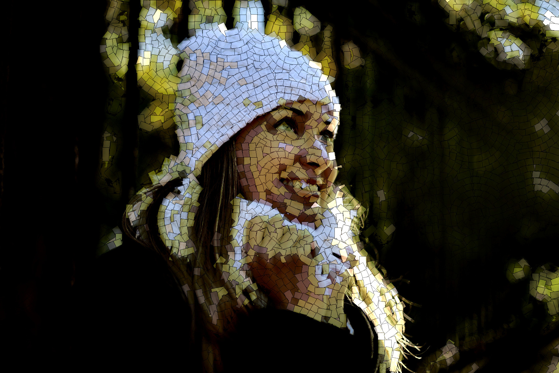

Thanks a lot Garry.
My first try (I'll have to play with parameters).
pexels-andrea-piacquadio-3760627_1800x1200_my-first-try.jpg [ 980.61 KiB | Viewed 4521 times ]

IMO the "fill holes" requires a better implementation (when "on"), often the holes are filled with too dark colour values with respect to the area colour.

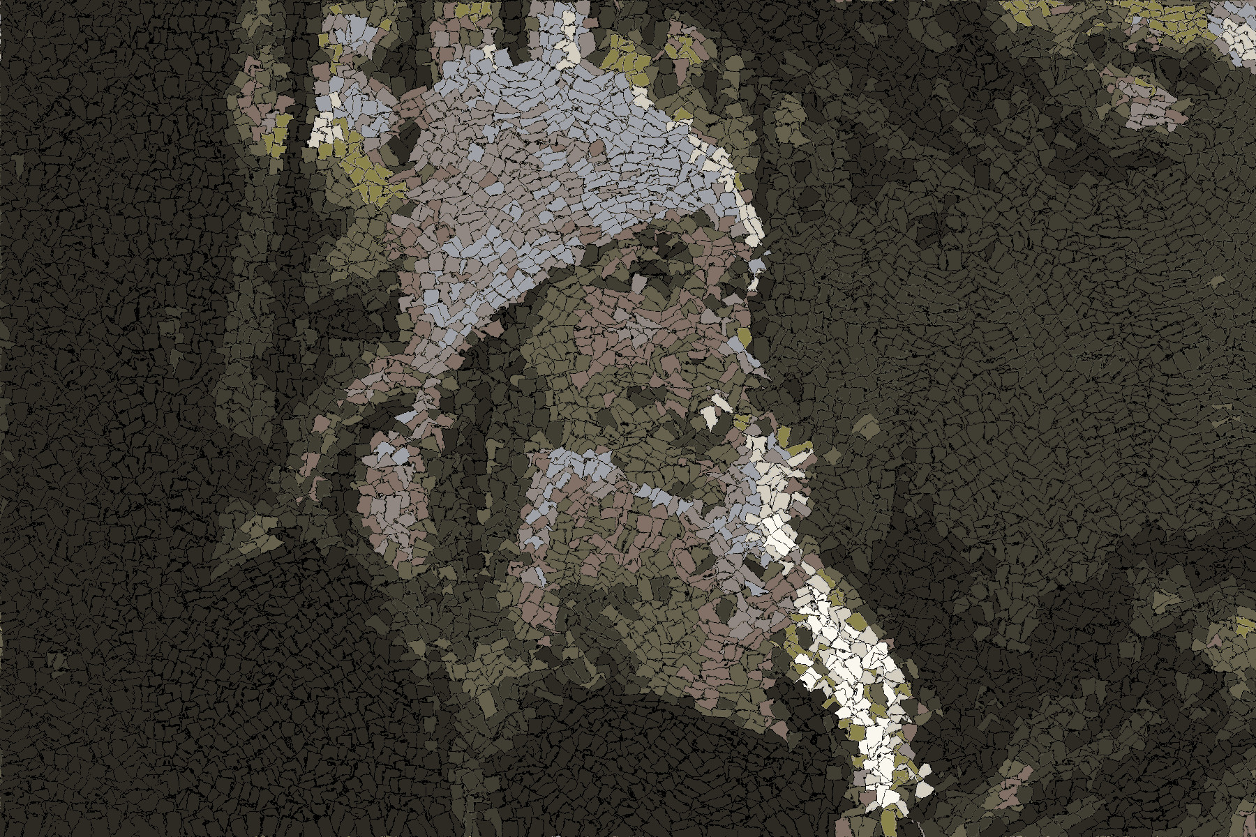

One outcome:
pexels-andrea-piacquadio-3760627_1800x1200_Garry-A using 12 colours.jpg [ 334.91 KiB | Viewed 4474 times ]
