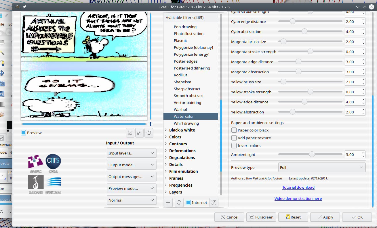

I am not sure when it was phased out but it is not there now ;) I can get it in a (linux) Gimp 2.8 and a gmic_gimp (gtk) 1.7.5
Lots of sliders, Looks like this:

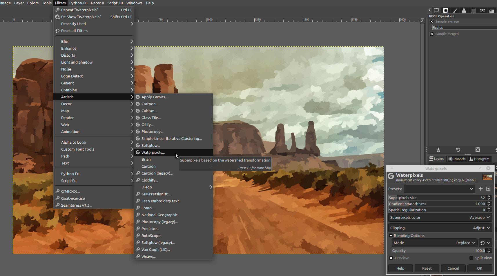

PostPosted: Tue Aug 03, 2021 6:54 am  (#5)
You can also try Gimp's "Waterpixels" filter.

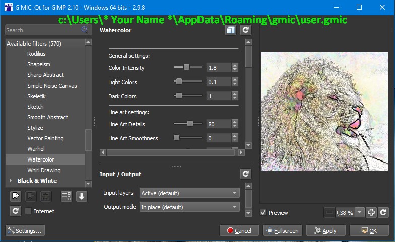

Hi Patrice.
I really appreciate Your actively seeking a solution for someone else.
For me, only this file location works in Windows:
c:\Users\* Your Name *\AppData\Roaming\gmic\user.gmic
The filename (before .gmic) can be anything you like (e.g.: watercolor.gmic instead of user.gmic).
This method won't work on the portable Windows version of Samj (unless someone is also using the Onkel_Hatti launchpad)
