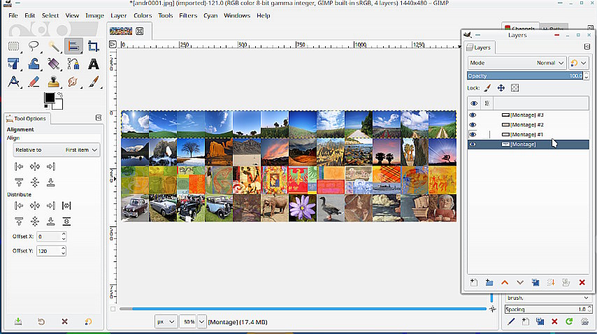

One possibility is toggling visibility on selected layers, and using the input selected option. Fairly quick if you know how to toggle layer visibility and use ctl-f to repeat gmic.
With a bit of editing you can end up with distributed layers, but a cumbersome process.
