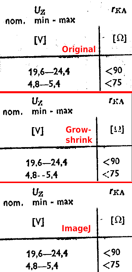

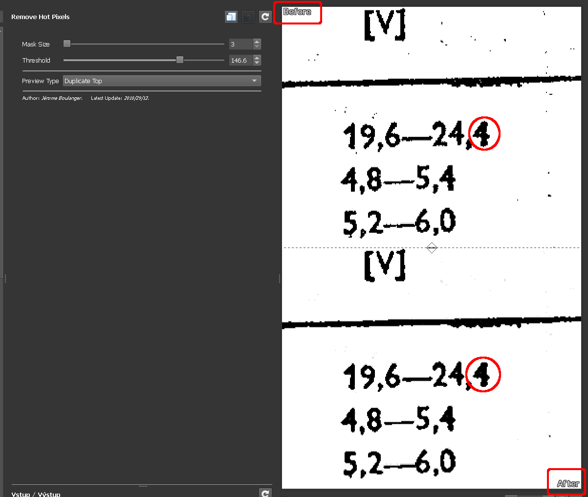

Hello, I occassionaly use GIMP with BIMP plugin to mass-process scanned documents. Now I have hundreds of monochrome (1-bit) pages that have lots of isolated black spots. Unfortunately, they can't be avoided, because the source documents were printed on cheap paper with visible wood pieces. I know there are complicated manual methods how I could remove them, but they can't be effectively automated with BIMP.
So I tried to use G'MIC to remove them with "Despeckle", "Remove Hot Pixels" and "Repair Scanned Document". However, all these filters have a common problem: they also remove isolated white spots. I'm attaching a screenshot which showcases it - the filters fill the insides of number "4", which is highly undesirable. Is there some trick to remove only black spots?
Also, G'MIC doesn't work on 1-bit images, I have to convert them to grayscale first. I don't like doing that, because some filters may blur the edges, which worsens readability after converting back to 1-bit. Is there some way around it?
Thanks!

I tried the grow/shrink method, but it's unusable, too many parts of text disappear.
I googled a way to do what I want, but it requires image processing program ImageJ that's usually used in medicine, tissue analysis and related fields. The results are very good, but it requires about 10 steps to get there, most importantly Analyze Particles function. I found it in thread "Is there a way to delete lonely pixels?" on Reddit. (This forum doesn't allow me to post links, because I'm a new user.) And unfortunately, making ImageJ batch-process multiple files is rather complicated.
Anyway, I'm attaching an image that compares the results.

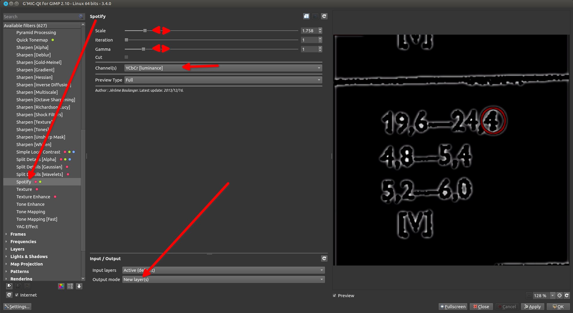

G'MIC > Details > Spotify to new layer
On the new black layer select with the fuzzy select tool in mode addition the big black part (no more specs...)
Then select the white layer in the layers' dialog and just drag and drop the white color from the FG/BG icon then Select > None
Result in one minute
Patrice

That Spotify trick is clever, but can't be automated because of the Fuzzy tool. (Hmm, "Spotify"... that became kind of confusing name today, hasn't it?) So I bit the bullet and made a macro for ImageJ, based on that Reddit thread. Actually, I made two versions of the macro: one standalone and second for its built-in batch tool.
The built-in batch tool is more user-friendly, you can open it via Process -> Batch -> Macro from the main menu. Then you must select input and output directories, output file format and paste this macro code (see screenshot below):
