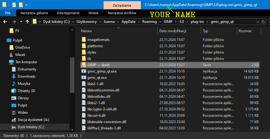

This is a good time to install G'MIC because the latest version 3.5.0 pre is available today.
Installation is simple:
1. Download the file from here
samj Créations
https://samjcreations.blogspot.com/2024 ... 6-300.html
and unpack it.
2. In the unpacked files find the directory
gmic_gimp_qt and copy it to
c:\Users\YOUR NAME\AppData\Roaming\GIMP\3.0\plug-ins\

I followed your instructions and it worked perfectly.
thak you enormously for your help!
I literally spent these last days trying to figure out how to install it for GIMP 3 but it was really hard for me to understand the complicated discussions on github, as I'm not familiar with anything coding and developing related!
so this very simple yet clear instructions are very much appreciated!
