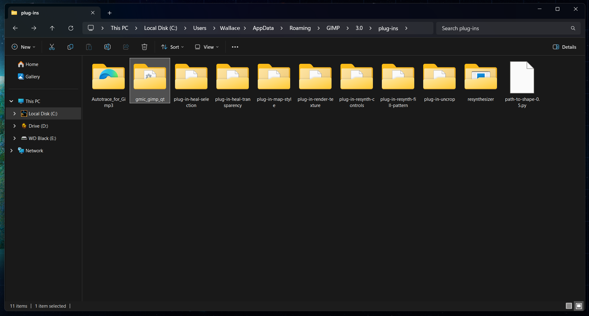

You could also check what was actually installed.
Go to:
C:\Users\<YourName>\AppData\Roaming\GIMP\3.2\plug-ins\gmic_gimp_qt
Check to see what files are in there.
File comment: Screenshot of my plug-ins 3.0 folder

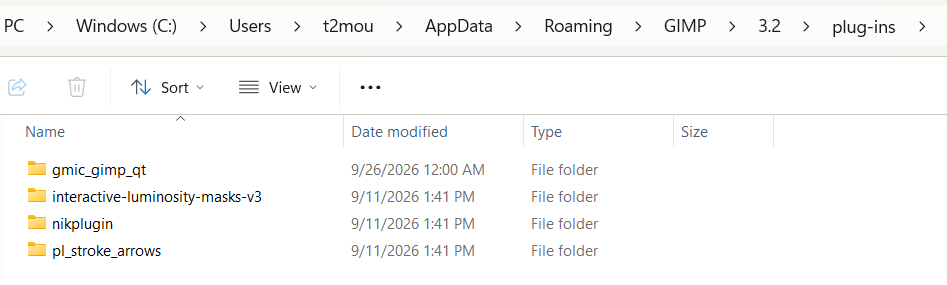

I thank you very much. You took the time to post all those folders. However, my setup is exactly like yours (plus a couple more files is some folder which would not create this issue). As mentioned in my first post, I have been working on this issue for over a week now and still no results. Very frustrating. I deleted the old gmic, reinstalled it using the exe file, did not work so deleted it again and used the zip download file. Still no result. Frustrating. :)
