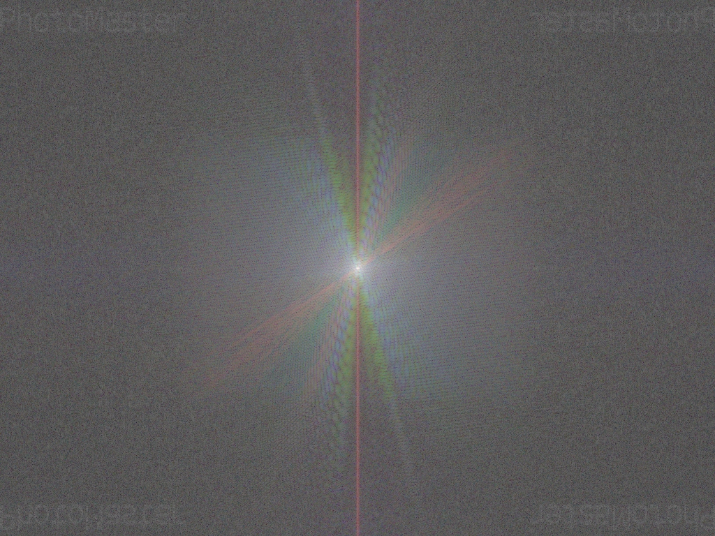

After saving the image, I opened it in Gimp and ran the "Fourier Analsis" filter in G"MIC and got this next image. Like I said, I love the filter. They need to fix memory holes to get it right! I soooo need this filter!!

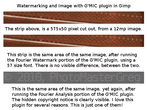

Have I said how much I love Gimp and G'MIC? I posted on the G'MIC forum on Flickr, about this issue and within 24 hours the author of G'MIC had updated the codes in G'MIC. All I had to do, was to hit the refresh button in G'Mic and it grabbed the update, in less than 1 second. It now works perfectly on a 12mp (4288x2848)file! This is beyond impressive!! Here is a little demo box I threw together! It shows a part of the image before the watermark, the same area after adding the watermark, and the same area after G'MIC revealed the hidden watermark. I Love It!!!
