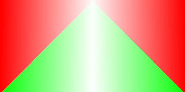

- - paste the faded original as a layer, left justified
- - flip the faded original
- - paste the flipped original as a layer, right justified
- - flatten the new image (see stitched)

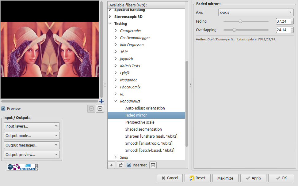

I gave a try, not sure if this is exactly what you want, just let me know.
Filter is under 'Testing/Ronounours/Faded mirror' and looks like this :
Just refresh your filters and it should appear.
PS : This is the piece of code I wrote for this effect : http://pastebin.com/g1MGD2Dh

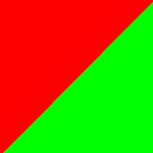

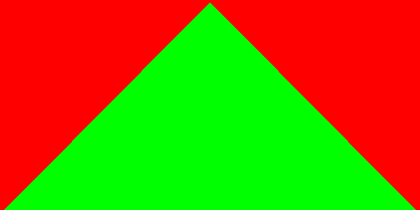

Hi Ron & GC
I started playing with the new gmic script kindly provided by Ron and commented by GC, and - what is my primary objective - I started also trying to understand each piece of code in order to be able to steal and create something.
First step I'm concentrated on is performing the fading effect.
So I tried to copy only that part but I didn't get any fading effect, so I came back to the full script FadedMirror and played with the values on fading and overlapping.
By doing so I noticed that the fading effect operates only on the overlapped part, if zero overlapping is chosen, even entering 100% fading no fading occurs.
I attach here 3 images:
1-original
2-faded-mirrored with parameters 0,0,0 (=x-axis, fading=0, overlap=0)
3-faded-mirrored with parameter 0,100,0 (=x-axis, fading=100, overlap=0)
images resulting from 2 and 3 are identical (alias: no fading in both cases)

To be more specific:
a - the new gmic function operates exactly as I like, for the purpose of stitching one image with itself reversed (in fact, in my simple python I had only one parameter, valid both for fading and overlapping)
b - my question in on the possibility for me to derive from there only the fading function to copy and paste it in another gmic function
What do I have to change from the first part of the code?
Many thanks...
(I attach here an image created manually with the result I thought would have been with 0,100,0; I repeat, not to alter the function which is perfect as it is, but to understand the code)
