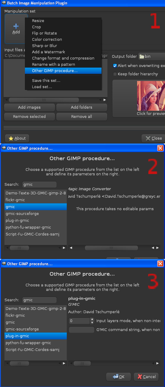

At first I thought BIMP (http://www.alessandrofrancesconi.it/projects/bimp/) can not take advantage of the great opportunities G'MIC (1).
It was a big mistake (2).
Input will suffice to put Layers mode on 1 as well as to write G'MIC command string (3).
But how to know the command? It is very simple.
The GMIC planning task order, set the parameters for each filter and save as Faves (4)
Open (in notepad) file gmic_faves (5) and make simple changes:
exchange this ->     {Cartoon}{Cartoon}{cartoon}{gimp_cartoon_preview}{3}{200}{20}{0.25}{1.5}{8}{0}
on this ->                 -gimp_cartoon_preview 3,200,20,0.25,1.5,8,0
Copy -gimp_cartoon_preview 3,200,20,0.25,1.5,8,0 and paste in G’MIC command (6)
