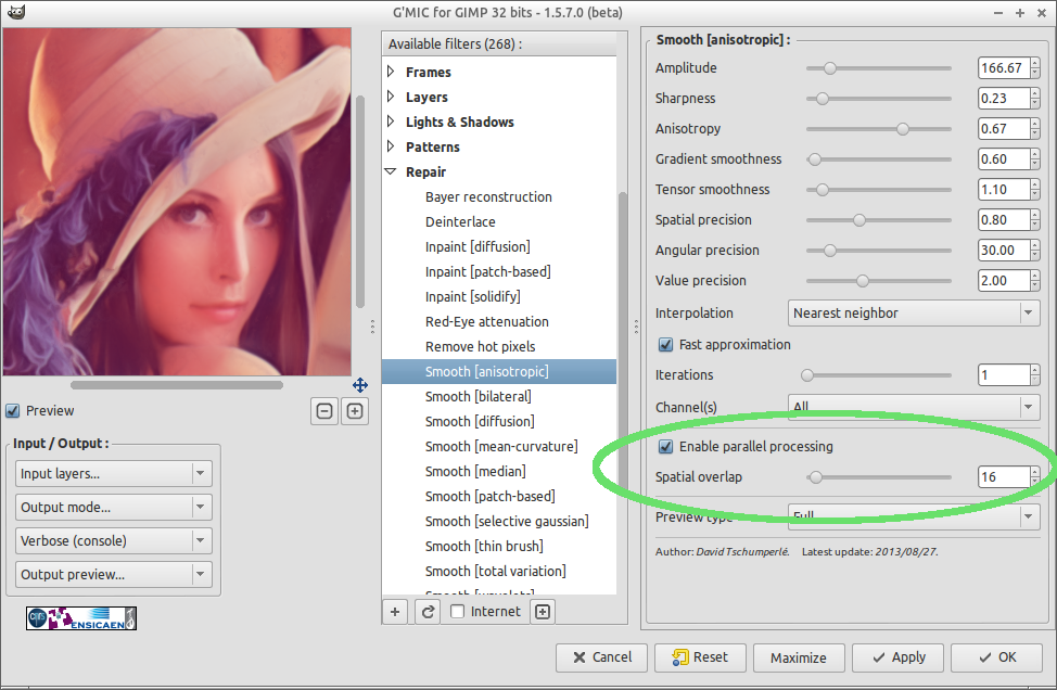

I've worked all these last days on the G'MIC code, in order to allow the execution of parallel operations in G'MIC filters, using several CPU cores if available. It seems I've reached the end of the big work, and I'd like to have your impressions/feedback on this.
I've posted new (beta) binaries of the G'MIC plug-in for GIMP, both for Linux and Windows users, and I've started to parallelize some of the G'MIC filters, mainly the 'Repair / Smooth [*]' family of filters.
Basically, if you have 4 cores in your CPU, you can expect a x4 gain on the computation time for these filters. You can of course disable the parallelization, to verify this is indeed slower (I hope so!).
This is how it looks (after a filter refresh of course) :
Note that if you are using 1.5.6.1, you will get the same parallelization option when refreshing your filters, but unfortunately, it won't run in parallel in this case.
Is there anyone willing to test and tell me if that is indeed faster with the parallelization option ?

Yes Rod. It can (now) uses up to 4 cores.
I've just tested it and indeed, I get a roughly x4 gain on the computation time on my images.
I'm very happy to say the least :)

This is so great! Thanks a lot Ronounours!!!
Kubuntu 64bit - i7-3770 with 4 cores (8 threads)
Image 6000x6000px - Smooth [anisotropic]
One core: 1min 45sec
Four cores (parallel processing): 0min 35 sec
Excellent!!! :yes

@YAFU : Nice result indeed :)
Multithreads and multicore does actually the same, from the computational point of view. New threads can be indeed executed on different cores of the CPU. That's the technique G'MIC now uses to speed parallelize the filters.

@Ronounours: I see. Just I clarify that my system monitor shows that only 4 threads are working with G'MIC.
I do not understand which filters use 4 threads or 8 threads in GIMP. For example, Gaussian Blur seems to use 4. Resynthesize uses 8 threads.

Joined: Jan 03, 2011
Posts: 1656
Yes, for now, I've explicitly limited filters to use 4 threads, but theoretically, G'MIC can use all of your cores.
Maybe I will improve that in the future.

Yep, it works fine for me. I'm running Linux Mint 15 64 bit and have a six core processor. I didn't time the Smooth Anisotropic filter but at a guess it appears to be about four times faster. Also I have conky set up on my desktop and it showed that four of the six processor cores were running at 100% whilst the filter was in action.
Great stuff much appreciated.

Just tried your compile samj; works great. Bilateral filter is now a little more spiffier on my system that is (dual-processor). Just wish I now had a quad-core. lol

I was able to cut the anisotropic smoothing from 53 seconds to 23 seconds on an Intel quad core. :jumpclap
