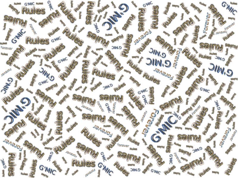

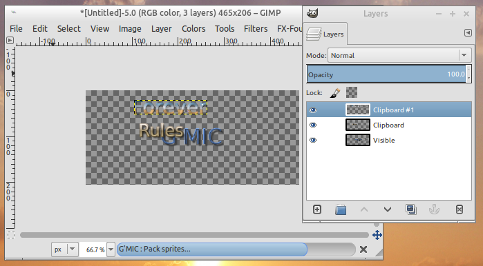

Here is an example. You can start with three different layers, here containing some text :

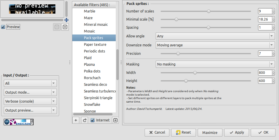

Then, you call 'G'MIC / Patterns / Pack sprites', do not forget to select 'Input Layers -> All' :
Set your desired parameters, then click 'OK' and go for a coffee (having more sprites make the filter slower to compute). Then you get your result :
Note that the sprites are really *randomly* packed, and if your sprites are not easily "packable", they may not appear at all in the final result ! (esp. if you consider a lot of different sprites to pack).
I would suggest to try packing sprites with equivalent sizes, for an optimal result.
Well, that's it. Now back to work :)

What I can suggest is that the more sprites you have, the more 'precision' should be considered in the packing algorithm. It corresponds to the number of attempts made to pack a sprite somewhere (randomly chosen) in the image.
