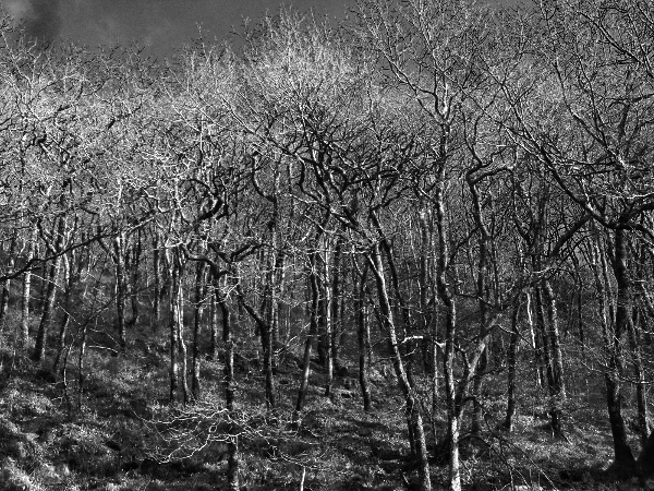

Well that was fun.
I made the script create a smaller image and put various emulations as layers to make it easy to compare the effects. I've attached a smaller .xcf to show what I created.
Thanks for the help.
Kevin
My favourite emulation for this image was the Rollei Ir 400:
