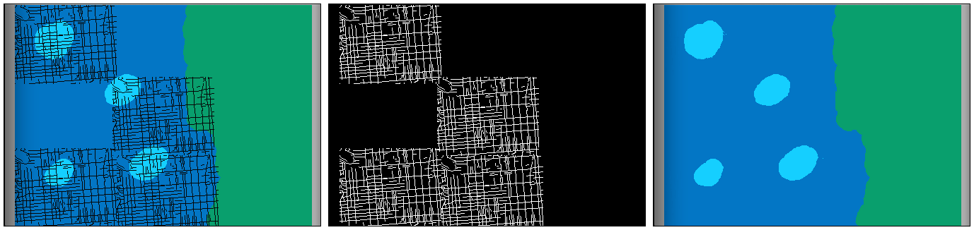

Ok, time for a proper example!
This works EXTREMELY well as you can see. I just want to disable the pixel smoothing seen here:
Could inpaint_flow possibly help me? I haven't had much luck getting it to work.

Well, using command -repair with a patch size of 3 and blending disabled, I get this :
which seems to be what you are looking for.
There are several inpaint algorithms in G'MIC, so you need to be aware of which is the best to use in your case (-repair here).
There are basically :
* -inpaint : you know it, it is very fast but does pixel averaging, so no way you can avoid new color shades appearing.
* - repair : a more sophisticated (and slower) patch-based inpainting algorithm. As it works basically with copy/pasting known patches to the locations of the inpainting mask, it is able to preserve exactly the original colors.
* -inpaint_flow : a PDE-based method for inpainting. Here again, you will get a smoother reconstruction (which is not what you want).
