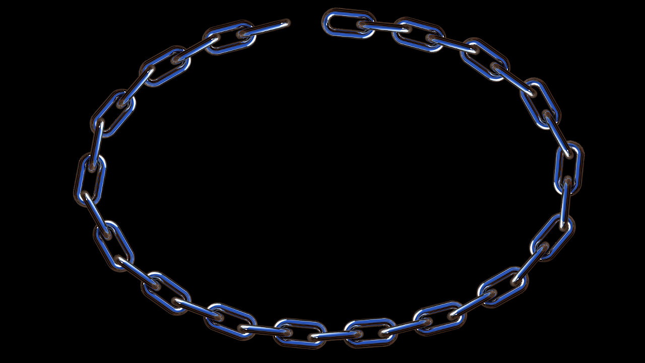

Animated Chain brush.
In brush tool dialog, select Angle to be around 6 or 7.
Step size at 60.

I like this one a lot. I opened the brush to examine how it was made, I never made an animated brush before. It looks like you duplicated your two links for 72 layers and rotated each layer by 5 degrees. Is there a way to automate that so I can make some of my own? I guess I could do it manually if I had to.

I had to manually rotate each layer. I opened two new images, one the size of all layers combined (rows and columns with guides and grid), and then a single cell layer, the size of one cell. I used rotate for each chain layer. Then used paste in place to copy them from the single cell into the larger image. The same was done with the rope layer. Tedious and time consuming. I think RobA made me a script to do this already. I've looked for it. I'll add it once I find it. I hope it still works with the new GIMP.

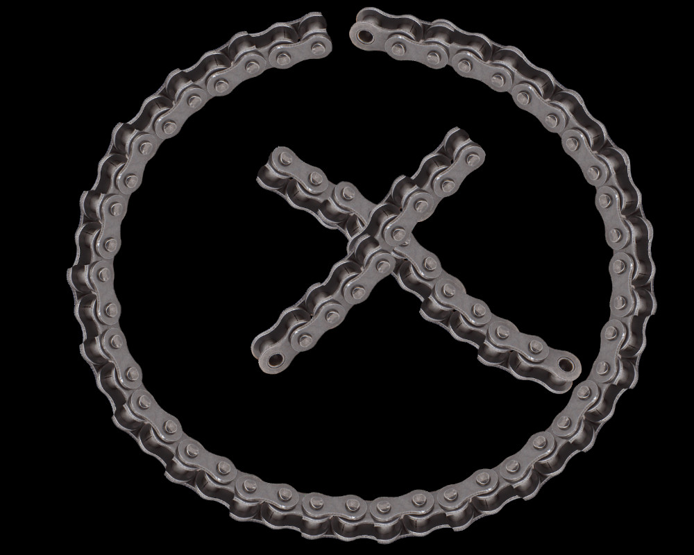

Well I made my first animated brush a Motorcycle Chain. It took way too long to rotate manually....
Chain-Bike.gih.zip [3.84 MiB]
Downloaded 314 times

Yeah, its tedious work. After 300+ rotations, my eyes had had enough, and I am still searching for RobA's script.
BTW, I added 6 to angle and your bike chain performed much better on my computer. In case anyone uses it and has problems.

Regardless of which brush you're referring to, each cell in the chain brush is angular. Each layer has a certain amount of rotation added, so as you draw out the brush, it follows the angle of rotation. The more layers and minimal rotations, the smoother the flow.

Correct.
In the rope brush, I had 13 cells, so 360/13 = 27 degrees for each cell of rotation. However, depending on the changed number of cells of the brush, you have to either account for aspect ratio or loss of angle within the steps between cells (which is close to half = 6.5 angular, so 6 -7 angle works out). The stitches required me to have blank cells so that they would skip between thread cells.
The chain, with 72 cells required 5 degrees of rotation. 360/72 = 5 degrees.

Thanks also for the chain brush, Mahvin. Really great! Racer, your bike chain is very realistic!

I made an animated chrome chain and it can be colorized into gold color if you want.
Chain-Chrome2.gih.zip [1.56 MiB]
Downloaded 267 times
