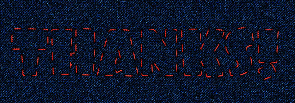

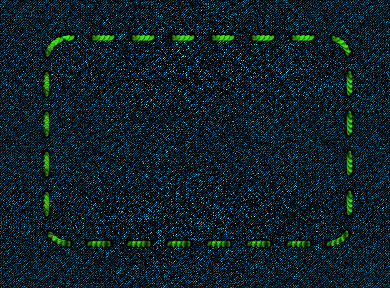

You're giving up too easily. It will not look good with a white background, use denim or some other fabric.
Started with 1280x720, applied G'mic denim.
Rectangle selection, round corners, selection to path.
Brush: white foreground color, size 80, spacing 1, dynamics off.
Stroke path: Stroke with a paint tool...emulate brush dynamics off, if you didn't do so in the paintbrush toolbox.
Changed the yarn color with Colors: Hue/Saturation.
Add a drop shadow, the way you want.
I like the old way: create a duplicate of the original, make it black using levels and then blur.
One more layer below the stitches, where I used round brush (hardness 075-090) on the end parts where the yarn penetrates the denim.
I'm happy with the end result, it was quick job. You must try again ;)

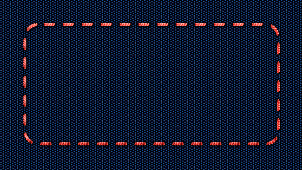

Thank you so much mahvin. I did my test too, I like it a lot. I'm sure I'll use it. :tyspin :coolthup

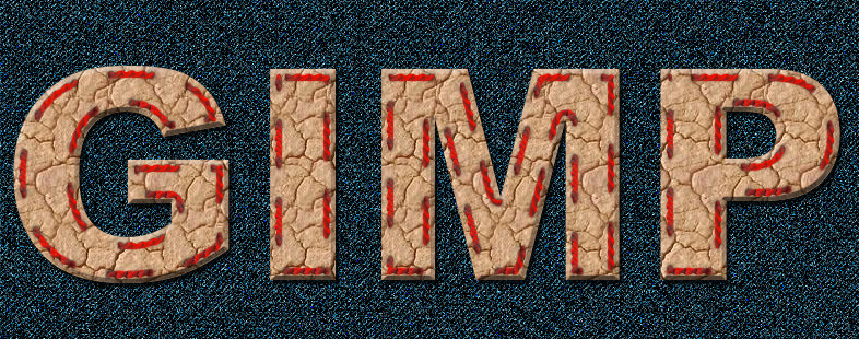

All anyone has to do is open the brush as image, then save it over writing the original. In the settings dialog, set spacing to 1. Then it will be the default when ever you use it. That's what I did with mine.
I'll attach my edited version if someone wants it. I reduced the gap between the stitches.
Stitch-mod.gih.zip [10.93 KiB]
Downloaded 303 times

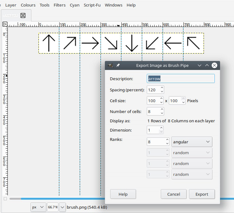

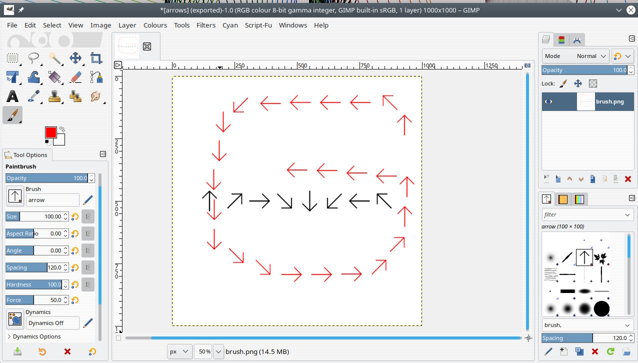

Sometimes it is easier to visualise the gih by creating the image as a strip rather than layers.
This time grayscale, takes the FG colour.
Its fascinating how much unexplored potential is in the brushpipe mechanic.
However i have a hard time seeing how working with a strip has any advantage when you have to rotate each cell.
With the clone layer tool you can make a brushpipe with many layers on one mouseclick.
