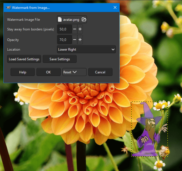

In Gimp-3.0.2-1 the plugin does not register in the menu and sys.stderr shows the message:
TypeError: Gimp.Procedure.add_file_argument() takes exactly 8 arguments (5 given)
I fixed it a bit, but the plugin behaves a bit strangely: Watermark Image File window - every time you run it, you have to search for the file again, because it opens with (none).
This line:
        procedure.add_file_argument ("file", _("Watermark Image File"),
                                         _("Watermark Imag File"), GObject.ParamFlags.READWRITE)
It was replaced with this:
        procedure.add_file_argument ("file", _("Watermark Image File"), _("Watermark Image File"),
                                         Gimp.FileChooserAction.OPEN,
                                         False, None, GObject.ParamFlags.READWRITE)
Is this normal behavior or is there something wrong with the code?

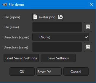

I checked how file-demo by Ofnuts behaves:
https://gitlab.com/gimp1614946/gimphelp ... type=heads
Select file to open:
For Re_Show:
Empty File (open):
For File (open) it doesn't work either:
Save Settings
Load Saved Settings
For Re_Show in Gimp-2.10.38-1
This is another major regression in Gimp 3.

A small step forward: :mrgreen:
- include position and different sizes of layers
- added option to merge watermark with active layer
To distinguish it from the original plug:
In menu: Filters ➤ Render ➤ Decor ➤ Watermark for Layer from Image
Watermark3_for_Layer.zip [2.58 KiB]
Downloaded 89 times

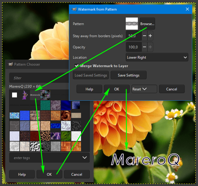

Another small change:
- I replaced "Image file" with (incorrect) pattern selection,
- Also included is a quietreader tip.
In menu: Filters ➤ Render ➤ Decor ➤ Watermark from Pattern
First, you need to save your watermark (image or text) as *.pat - and you will always have it at hand.
From your prepared watermark, you can create a pattern very quickly:
Edit: Sorry - attachment changed (incorrect one uploaded previously)
Watermark3_from_Pattern.zip [2.73 KiB]
Downloaded 80 times
