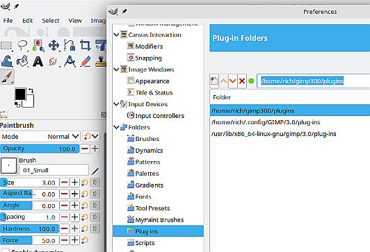

Why not ? Anything to make things easier. When Gimp 2.10 moved the User profile I started using a separate folder for resources - not just plug-ins, but scripts , fonts , patterns .... Plugins like gmic which come with a Windows installer, let them use the default but if you have to install manually, easier if you do not need that appdata/roaming nonsense.
What you do not want to do, as is sometimes seen here, is a separate path for each-and-every plugin
A bit easier with linux than Windows, for example this for my Gimp 3.0 plug-ins
