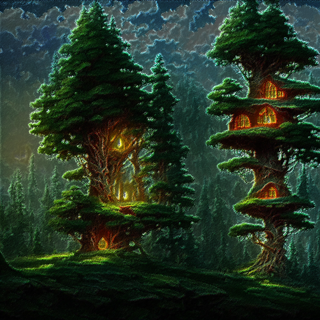

This plugin creates an Embroidery Effect on your opened image, or layer.
Works best with lots of colors.
No dialog, just run the filter and it creates the effect.
Image created in Gimp using Gimp Stable Diffusion (AI text to Image plugin for Gimp-2.10).
viewtopic.php?f=9&t=21674
Results after running the filter on the open image.
Plugin can be found under Rod>Artistic>Embroidery Stitcher. You can change that menu location if you wish. I prefer to have all my newly installed filters under each creator's name.
Where to install -
Gimp-3.0/Plugins folder It is a scm filter but needs to be unzipped to your plugins folder to work.
Instructions to use -
Just select the layer your image is on and run the filter. Everything is automatic. The filter will keep the original image and create the effect layer above it. The GEGL FX are not saved.
Have fun! :bigthup

Another tree house image
