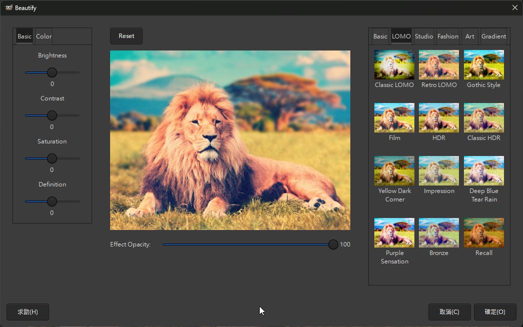

Windows binary package, because the bug, so not include simple-border
And one more thing
old gimp_curves_spline and new gimp_drawable_curves_spline
same control points but not the same result
Beautify3.0.zip
gimp_drawable_curves_spline uses GMIC Curves instead, The result is similar to version 2.10
beautify_beautify(use GMIC Curves).zip

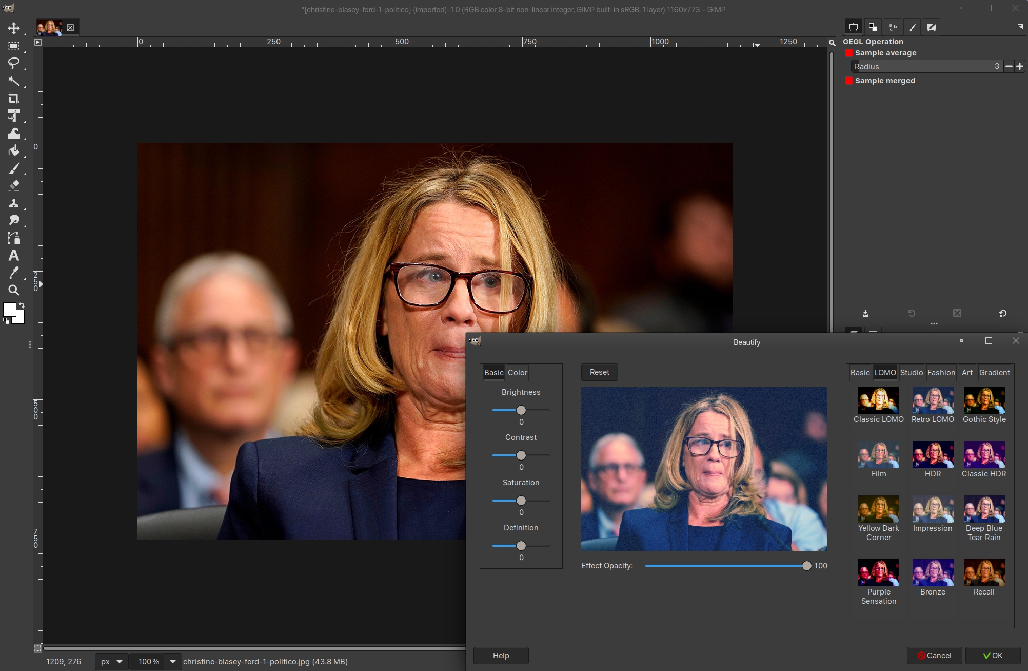

Looks good on Linux -- (k)Ubuntu Noble 24.04
GIMP 3.0.0-RC2 & dev packages installed from Mateusz Łukasik's mati75 gimp 3.0 PPA
Just had to modify the Makefile:
From:
LIBS = $(GIMP_LIBS) -lm -mwindows
# LIBS = $(GIMP_LIBS) -lm
To:
# LIBS = $(GIMP_LIBS) -lm -mwindows
Build:
$ make
Launch:
$ gimp --verbose

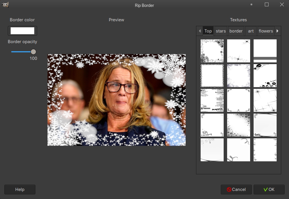

Querying plug-in: '/home/USER/.config/GIMP/3.0/plug-ins/beautify_texture-border/beautify_texture-border'
Querying plug-in: '/home/USER/.config/GIMP/3.0/plug-ins/beautify_skin-whitening/beautify_skin-whitening'
Querying plug-in: '/home/USER/.config/GIMP/3.0/plug-ins/beautify_simple-border/beautify_simple-border'
Querying plug-in: '/home/USER/.config/GIMP/3.0/plug-ins/beautify_rip-border/beautify_rip-border'
Querying plug-in: '/home/USER/.config/GIMP/3.0/plug-ins/beautify_beautify/beautify_beautify'

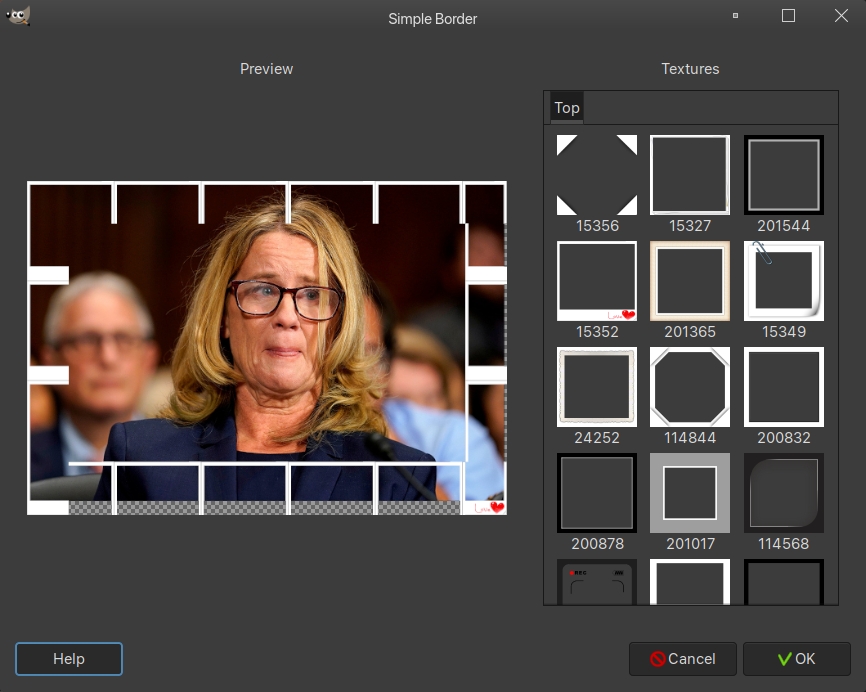

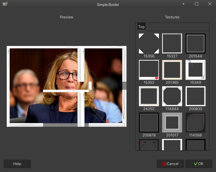

I suppose this is the bug with simple-border that you were referring to. Hopefully it can be fixed.

WARNING: the beautify_simple-border plug-in is just for reference. It doesn't work as discussed above.
