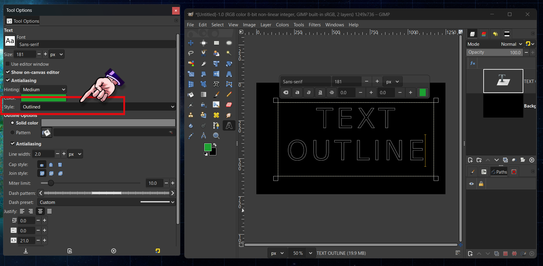

You can also find text outline style within the text tool options as well.

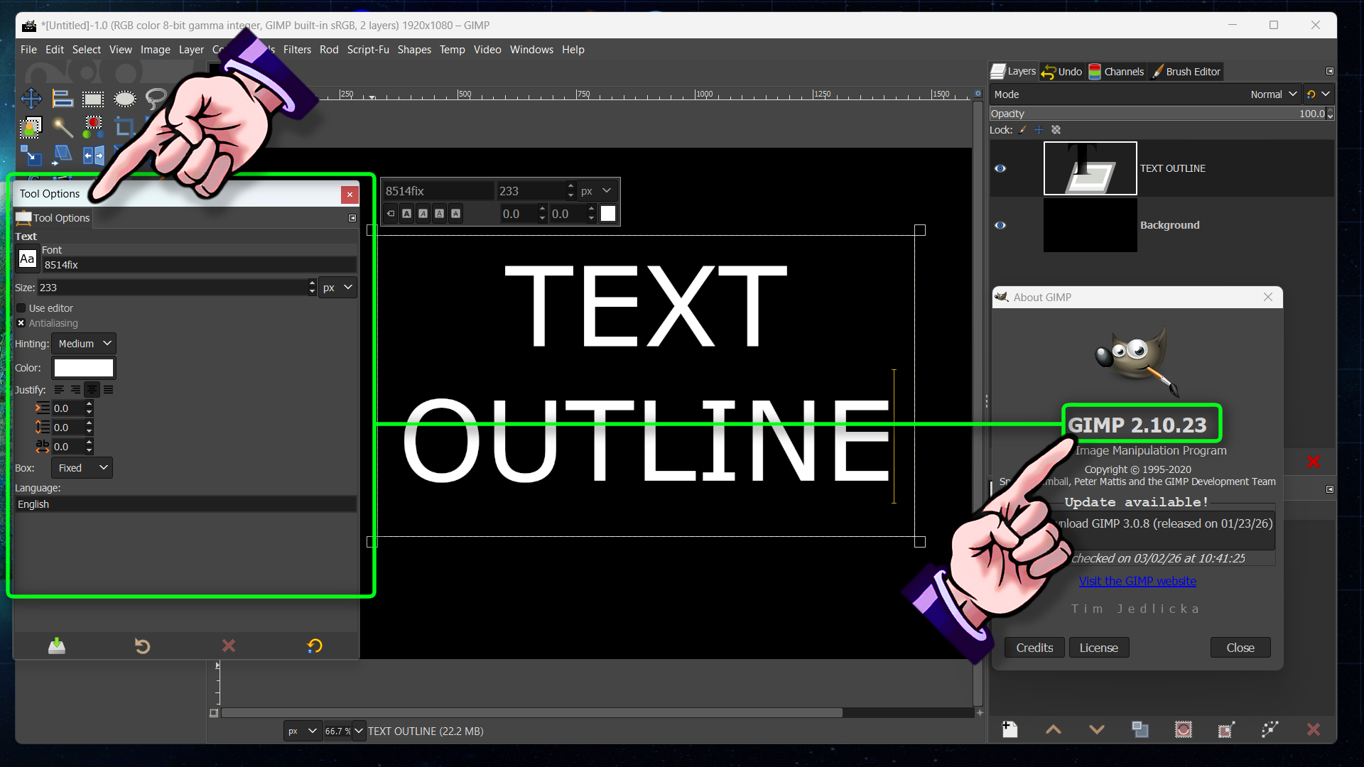

GIMP 3.0 adds native text styling in the Text Tool Options
(Filled, Outlined, and Outlined & Filled).
To facilitate non-destructive, editable outlines, strokes, patterns,
and dashes directly from the tool options.
Much easier to accomplish than in 2.10.
File comment: GIMP 2.10 Text Tool Options
