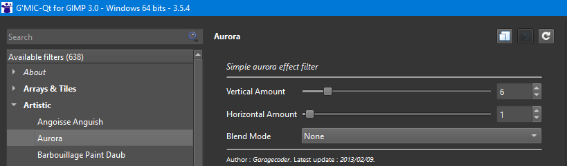

For some reason unknown to me (since I don't know Python3 or the Gimp3 API :oops: ), a respected forum user asked me for an example of a py plugin using G'MIC.
It's nothing interesting except for a simple example.
In menu: Test ➤ Average py
Edited to include a screenshot from G'MIC
Gmic_average.zip [2.12 KiB]
Downloaded 2609 times

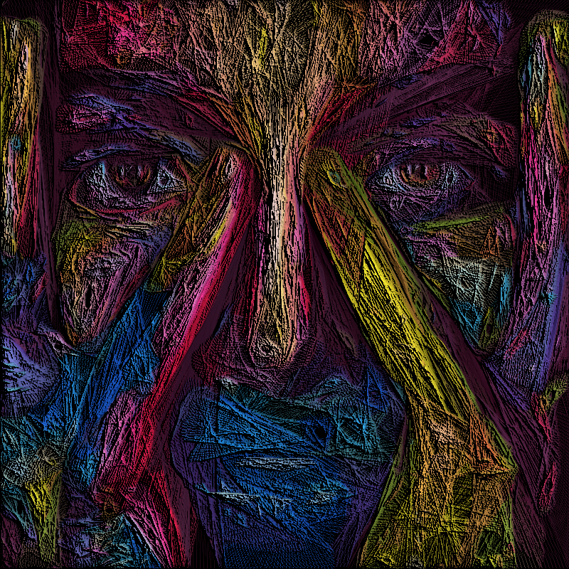

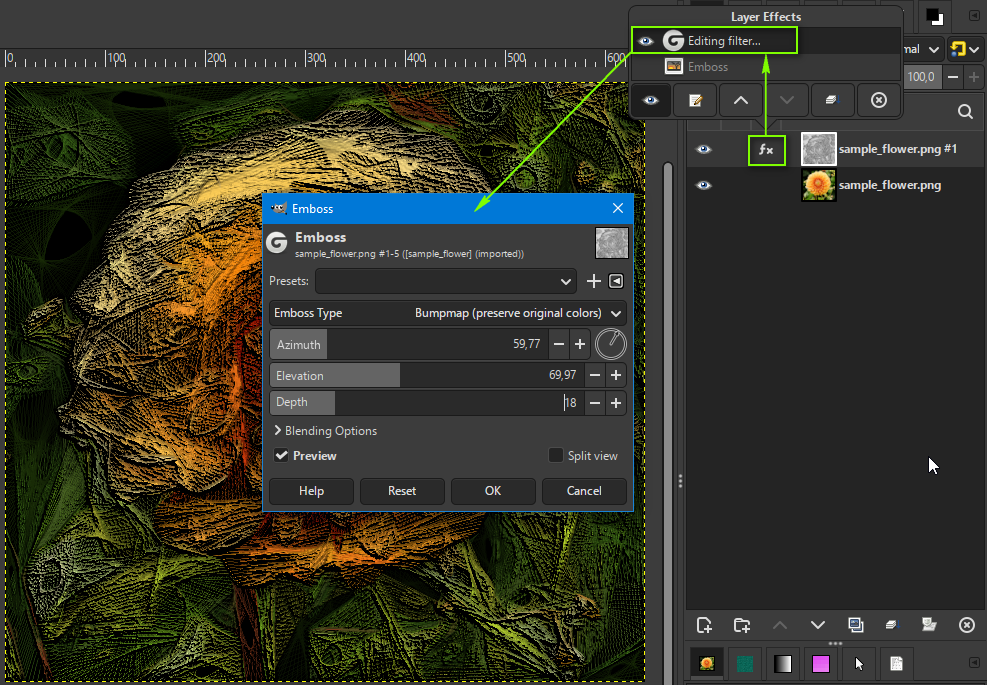

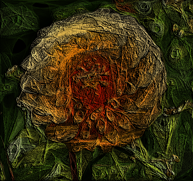

A bit more extensive usage example: G'MIC and GEGL
- using GEGL based on Choice-demo.py by Ofnuts,
- new widgets based on widget_variants.py by Nelo.
In menu: Test ➤ GMIC Stringify and GEGL Emboss
GMIC Stringify:
GEGL Emboss:
Gmic_stringify_and_Gegl_Emboss.py:

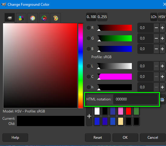

Background Color is HTML Notation:
Example 1:
Example 2:
Gmic_stringify_and_Gegl_Emboss.zip [3.56 KiB]
Downloaded 610 times

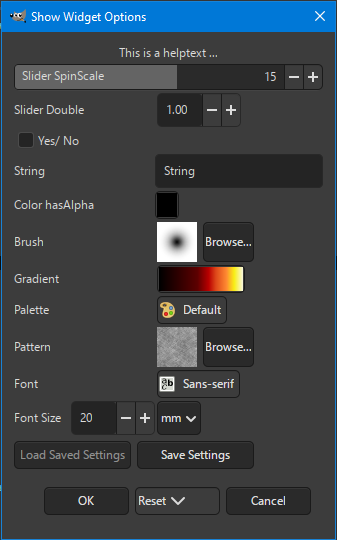

I have slightly updated widget_variantions.py by Nelo.
However, there are still no equivalents from Gimp2: PF_VECTORS, PF_TEXT.
In menu: Test ➤ Show Widget Options
This code fragment is responsible for displaying widgets:
You will only need some of them for your plugin, so you can disable unnecessary ones
# -> comment on widgets you won't use
Show_Widget_Options.zip [3.57 KiB]
Downloaded 588 times
