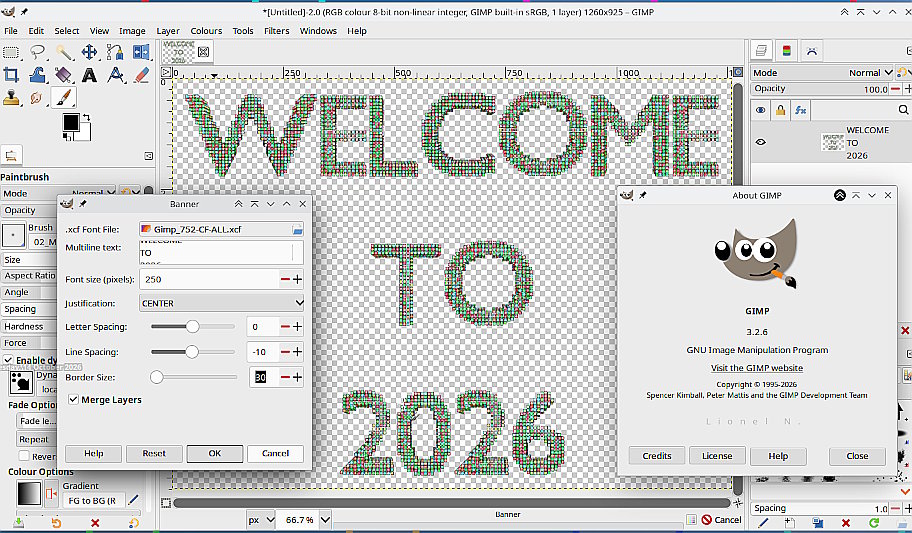

I can and do run a Gimp 2.10 but maybe someone can update for Gimp 3. I ran Tin Trans original script-fu through Claude AI for a Gimp 3 version. The result does work although easy to crash, for example using characters that do not exist in the xcf custom font file (typically missing lower case) locks the script.

Come on Gimp users, some clever people here, get coding. Gimp 3 custom-font-banner.scm attached

Works for me in Gimp-3.2.6 with Windows 10 :) :bigthup
Good one Rich!
