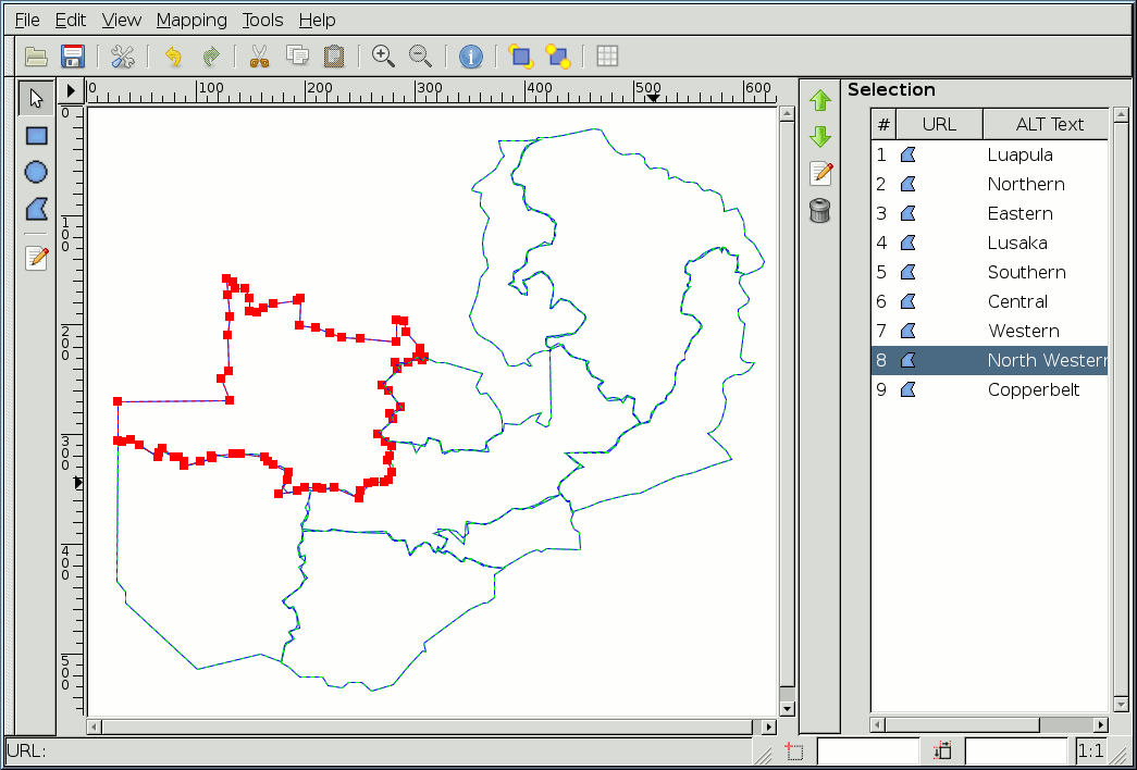

Filters->Web->Save Path(s) as HTML poly map...
http://chiselapp.com/user/saulgoode/rep ... th-as-poly
  • Make your selection
  • Convert it to a path ("Select->To Path")
  • Use the script to save your path(s) to a .map file
  • Open the Image Map plug-in
  • Open the .map file

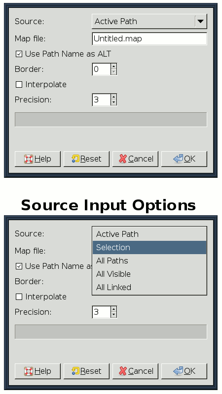

Maybe you can add a call to plug-in-sel2path?
 Post subject: Re: Area image selection transfer to Image Map polygon
PostPosted: Mon Dec 02, 2013 9:02 pm  (#14)
Joined: Apr 23, 2010
Posts: 1553
I've also added options to only use either visible or linked paths.
The command is also added to the Paths context menu available by right-clicking on a path in the Paths Dialog.
