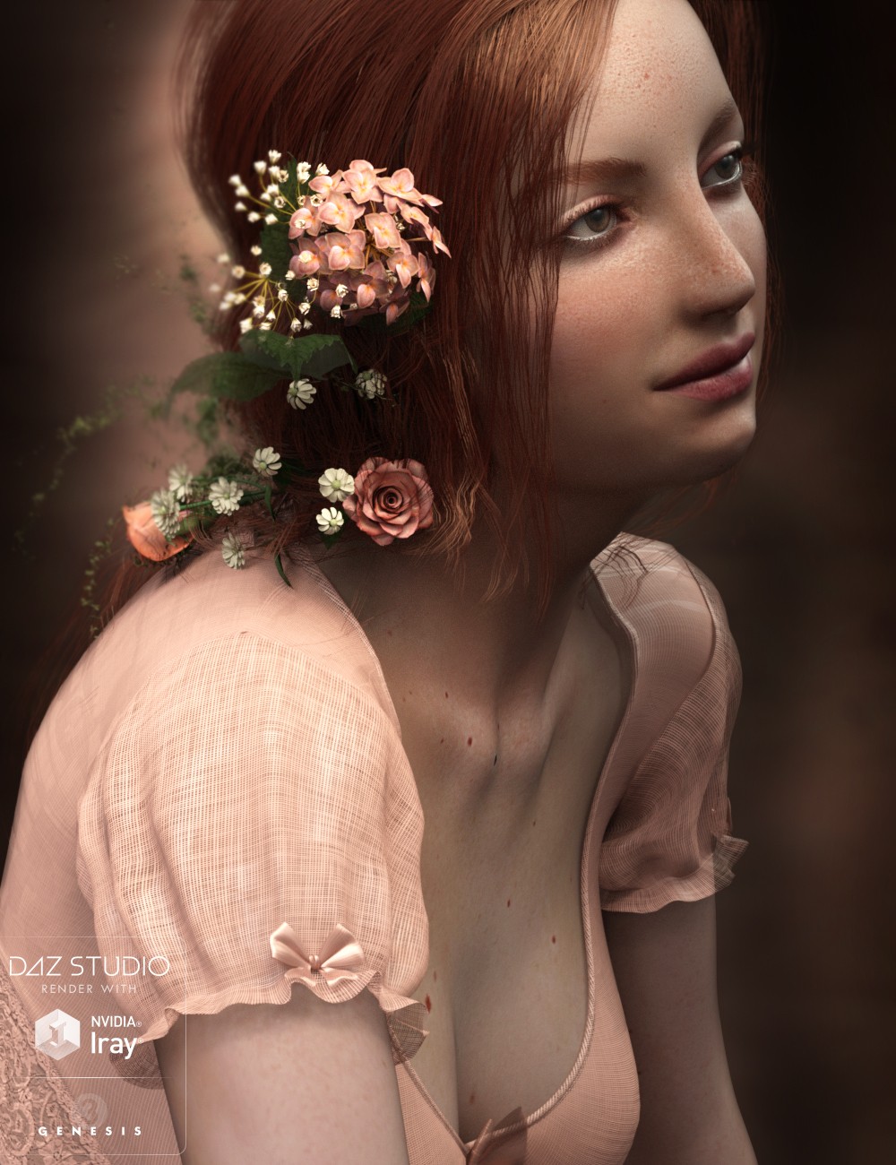

File comment: This is the original.

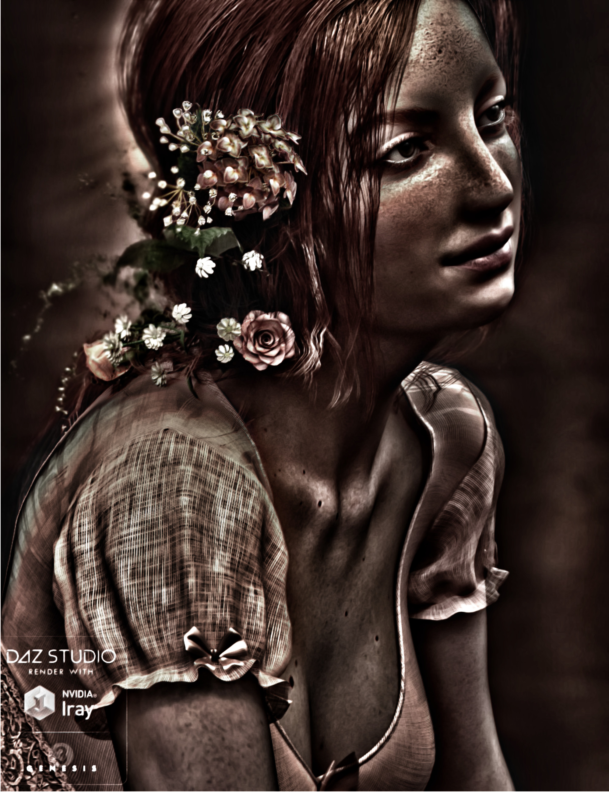

Hi AMucha, I tried that effect by applying a filter of my friend Dinasset. Is this what you want to get?

My process was this:
open your original layer and apply "DaveHillEffect" in strong option in Keil Effect.
Then I applied (G'MIC-white and black- Emboss) to original layer and set the result under DaveHillEffect and set it (upper layer) to SoftLight layer mode.
I suppose you can add more colour.
Luck!

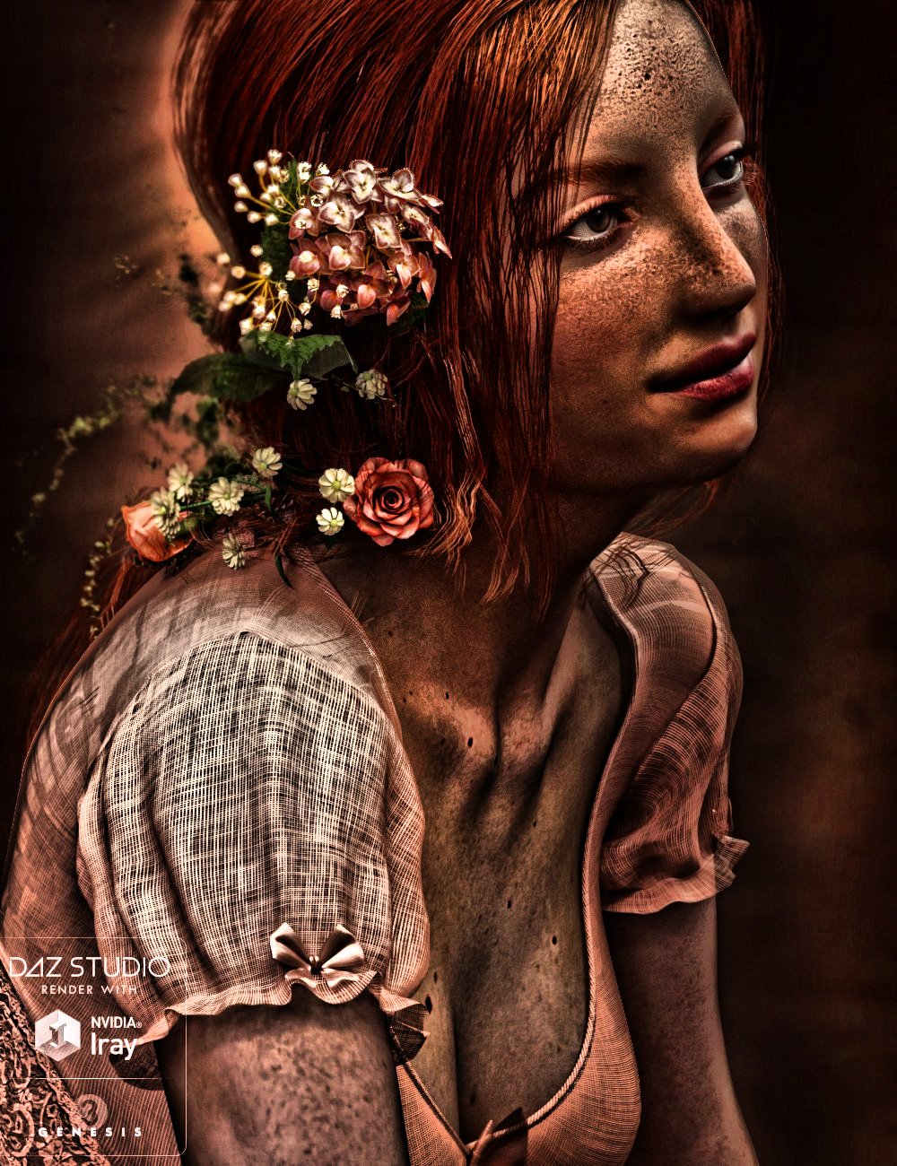

Once you have G'MIC QT properly installed and running you may get a result like this simply using:
- increase saturation (Gimp +100)
- G'MIC freaky details (new layer)
- G'MIC emboss (midpoint 200) (new layer)
and playing with layer modes (multiply embossed layer over freaky output)

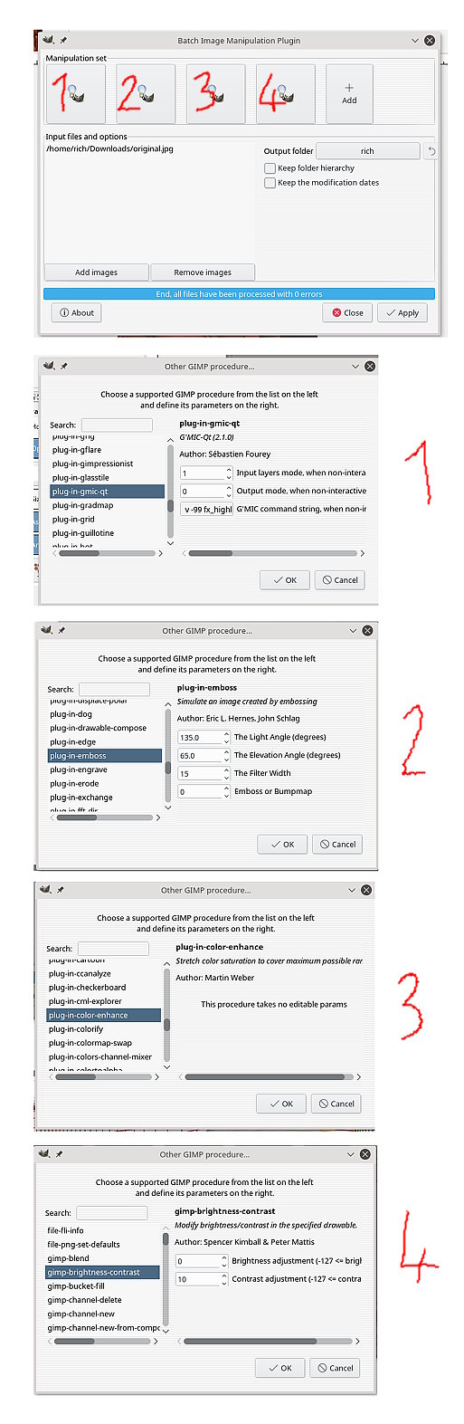

Part of the original question is being missed
...I would like to use BIMP to semi-automatize and apply 'X effects' as needed on series of images.
With BIMP you do really need to avoid adding extra layers. I can get to here, but only using the extra plugin gmic_gimp_qt see: http://www.gmic.eu
The BIMP structure looks like this, all 'other gimp procedures'
1. The gmic filter, this takes 1 for the input layer and a command line v -99 fx_highlight_bloom 26.4,86.19,140.51,31,29.4,0
2. The Emboss filter, you can use BumpMap here but emboss is simpler
3. Auto enhance - no parameters here
4. A bit of extra contrast.
A zipped bimp file example.bimp attached, remember to unzip it.
On a more general note, every image has to judged on its own merits, very difficult to create a recipe that is universal.
