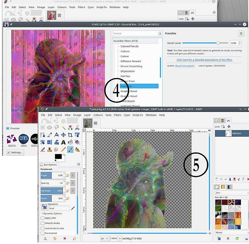

Transparency is just a mask, initially it does not remove anything. If you use your Path -> Selection -> Cut procedure (1) Then use the eraser tool in Anti-Erase mode (2)'s You can recover those 'cut' pixels. There are options with some formats. For example exporting as a png, untick "Save colour values from transparent pixels" (3) The mask is still there but will show as a solid colour.
Not really a help with a gmic filter like (4) As far as I know, the only work-around is to keep a selection in place. Layer -> Transparency -> Alpha to selection (5). If it messes up the filter then save selection to a channel and apply the selection afterwards.

Posts: 2613
I do not have that problem with the cloned out bits. Some quick examples.
This the base image with those areas cloned out.
Just a guess but check the input in the gmic dialogue. Make sure it is active and not 'all' or 'active and below' which might pick up the un-corrected image. As before even if the background is removed it comes back.
For the threshold etch, just my opinion, remove the alpha channel before applying the filter, then cut again afterwards. Might give just that little better result.

Something in your workflow for those cloned out pieces, however
Eraser Anti-erase mode - just an example that the cut pixels are still there in some form and some gmic filters pick them up.
How you get round that depends on the filter. You already have the path. Apply again, and recut the background.

Posts: 14831
I confirm partially what you noticed (about the use of clone tool).
Used clone tool to "apparently" override those three disturbing pieces you showed.
Used the "apparently" clean image as source for 3 of my filters: no removed objects shown on 2 of them, yes on the third one.
Stretching the "apparently" clean image those 3 areas re-appear.
But - at least for the clone tool - the problem seems to be in the default parameter "force" which is set to 50%; using 100% the problem seems to disappear.
