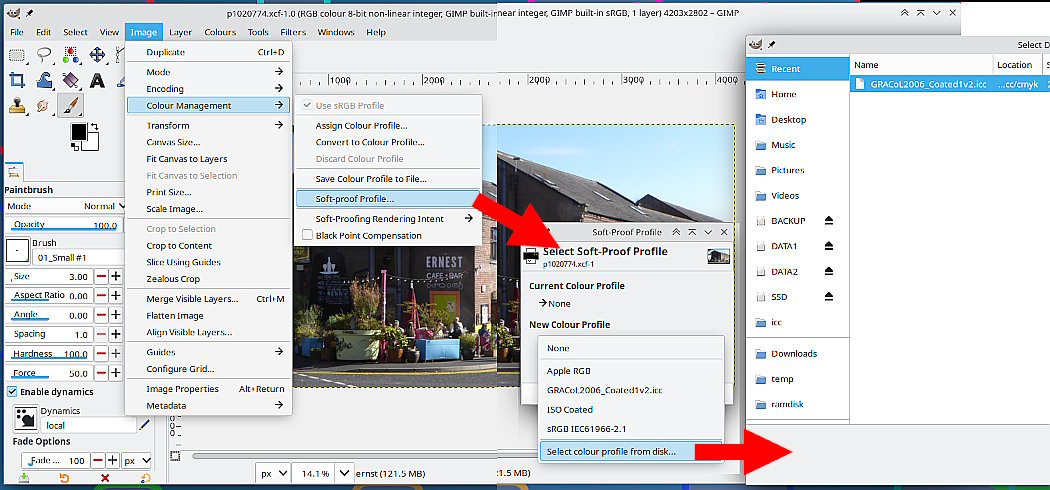

No CMYK profile is normal. Gimp is a RGB editor and the only built-in profile is the Gimp sRGB.icc
You do need to ask the client which profile to use, you can often find here: https://www.color.org/registry/index.xalter otherwise for special purposes the printing co provides.
Gimp can export a CMYK file in certain formats - JPEG / TIFF / PSD
In pictures, set up a "soft-proofing" profile

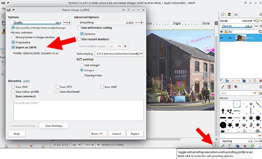

For printing enable the cmyk option.
Just a comment on Gimp 3.0.6 A nice little addition where you can toggle softproofing on and off. With soft proofing on - lots of magenta - too many out of gamut bright colours, your design is not going to print very well.
