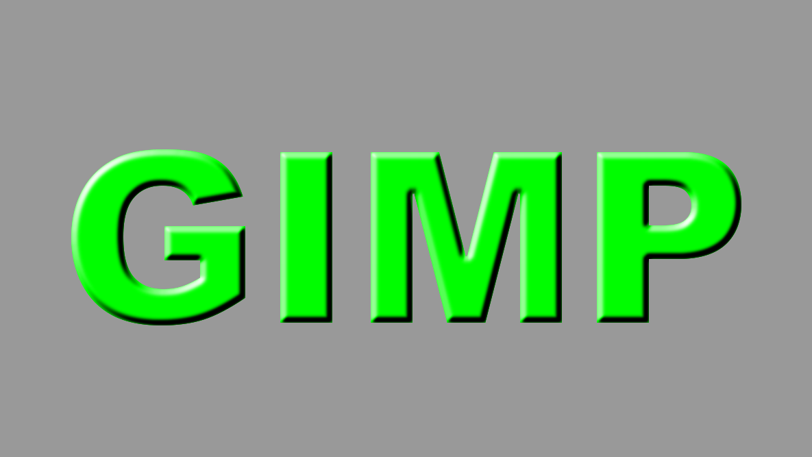

heres what i got, i tried what pegleg showed, but tbh, he does it with a script.....then i had another look at jamac4k's pdf
played around a bit, deleted several tries and then it dawned me:
it goes like this
01. type your text (i used Sans Bold 430px)
02. alpha to selection and save in a channel (just in case)
03. shrink selection by 5px
04. invert
05. fill with black on a new transparent layer
06. deselect and blur by 10
07. alpha select your text again and make a layermask from selection on the filled-with-black-layer
08. duplicate black layer (with the layermask) and invert color
now you have two layers with layermasks: one black (shadow) and one white (highlight)
09. according to your lightsource, erase the parts on your layermask you dont want, by painting on it with black
if the highlight layer is on top, you only need to edit that layermask and leave the shadow layer as it is
10. set shadow layer to 'Multiply' 75% and highlight-layer to 'Screen' at 75% opacity

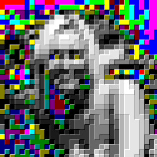

AnMal one way to get a fairly good transparent bevel is to use the filter edge detect sobel. Here is an Image created using this technique
The bevel is all on a seperate layer and starts at step 16 of this tutorial
Cubism
1. Open new layer A3 set to landscape. Go Layer>Transparency>Add Alpha Channel.
2. Go Filter>Render>Clouds>Plasma set Turbulence to 7 check Randomize click OK.
3. Go Layers>Transform>Offset set Y axis to 49 Check wrap around and click OK.
4. Go Filter>Blur>Pixelise set Height and Width to 155 click OK.
5. Go Layers>Transform>Offset set Y axis to 49 Check wrap around and click OK.
6. Duplicate Layer and Go>Colours>desaturate Check Luminosity and click OK.
7. Duplicate Grey scale Layer and Base Layer Again. Reposition Layers to go Grey, Colour, Grey & Colour.
8. Change top Grey Layer Mode to Dodge and the Second Grey Layer Mode to Burn.
9. Select the top Grey Layer and Go Layers>Merge Down
10. Select the Bottom Grey Layer and Go Layers>Merge down
11. Select the Top Layer and Change Layer Mode to Grain Merge, Go Layer>Merge Down
12. Go>Colours>desaturate Check Luminosity and click OK.
13. Go>Colours>Posturize set Posturize Level to 36 then Click OK.
14. Select a desired Palette from Palettes Dialogue window.
15. Go>Colours>Map>Palette Map
16. Duplicate Layer Twice, Select Middle Layer.
17. Go>Filter>Edge Detect>Sobel check Sobel Horizontal Uncheck Sobel Vertical Check Keep sign of Result (one direction Only)
18. Select top Layer
19. Go>Filter>Edge Detect>Sobel uncheck Sobel Horizontal check Sobel Vertical Check Keep sign of Result (one direction Only)
20. Select the Top Layer and Change Layer Mode to Grain Merge, Go Layer>Merge Down
21. Go Select by Colour, Uncheck all Boxes set Threshold to 0 and Select by to Composite
22. Click on the large grey area of Image.
23. Go Edit>Clear then Go Select>None.
24. Go>Colours>desaturate Check Luminosity and click OK.
25. Turn off all other layers except top Layer. Select Top Layer, change Layer Mode to Overlay and Duplicate Layer 5*.
26. Right Click on one of the layers and select Merge Visible Layers click OK.
27. Turn off all other layers except top Layer. Select Top Layer, change Layer Mode to Overlay and Duplicate Layer 5*.
28. Right Click on one of the layers and select Merge Visible Layers click OK.
29. Go Colours Invert, Duplicate Layer.
30. Select Top Layer, Go Layers>Transform>Offset set Z Axis to 1, set Y axis to1 Check Make Transparent and click OK.
31. Select Next Layer Down, Go Layers>Transform>Offset set Z Axis to -1, set Y axis to-1 Check Make Transparent and click OK.
32. Go>Layer>Merge Down
33. Duplicate Layer, Select top Layer.
34. Go>Filters>Blur>Gaussians Blur set Height to 25 and width to 25 Click OK.
35. Turn off all other layers except top Layer. Select Top Layer, Duplicate Layer 5*.
36. Right Click on one of the layers and select Merge Visible Layers click OK and change Layer Mode to Overlay.
37. Select the Middle Layer.
38. Go>Filters>Blur>Gaussians Blur set Height to 5 and width to 5 Click OK, change Layer Mode to Overlay.
If you want to see some more examples the go here He4rty's Cubism Gallery

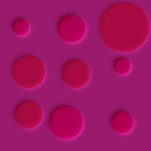

I wasn't happy with the soft look of large bevels created with blurring and bump-mapping, so I wrote the chisel script: http://registry.gimp.org/node/24217 which creates a linear heightfield to bump with rather than the gaussian curved heightfield that a blur gives you.
I discovered later that I re-invented the same technique already used by the layer effect script :P
-Rob A>

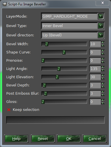

Graechan wrote:
I made my own from a tutorial some time ago and the results closely follows the one in layerfx and from iccii and it always comes in handy but I do not remember where the tute was from(head scratch)
I've decided to post it now even though it may be considered not quite to par others may find it interesting
script deleted by graechan

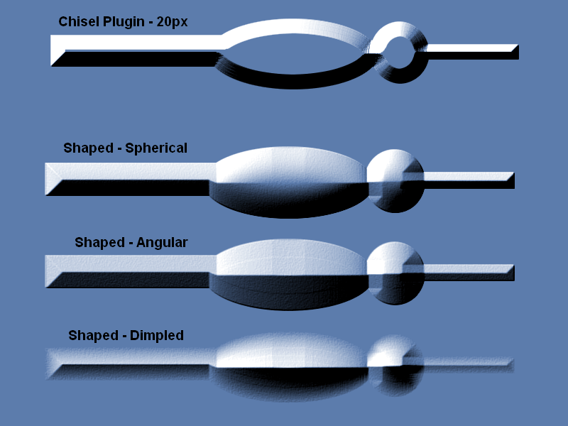

RobA wrote:
I wrote the chisel script: which creates a linear heightfield to bump with
thanks for the link !
am i correct this effect is achieved by filling the selection with a dimpled gradient for the bumpmap ?
i used that technique for my signature text effect
Graechan:
thanks for the fx-foundry-script !
that was very interesting, because you keep all the layermasks, so that one can guess how the script achieved the effect
it seems the fx-foundry script uses the same procedure for bevels, that i "discovered" on my own
it also seems, that technique is a simple method of doing bevels, because the layerfx-plugin bevel looks different (more advanced)
that again means im not yet there :(

You are quite welcome. No, I didn't like the results with the shaped gradients. Here are two examples showing how it creates artifacts:
The method my chisel script uses is to create a series of 1 px smaller (or larger) selection and filling them with changing shades of grey. This gives a bevel that follows the contours of the original selection much more accurately. It also seems to eliminate some of the stippling that gets created when using dithering in the shaped gradients to try and eliminate banding.
-Rob A>
